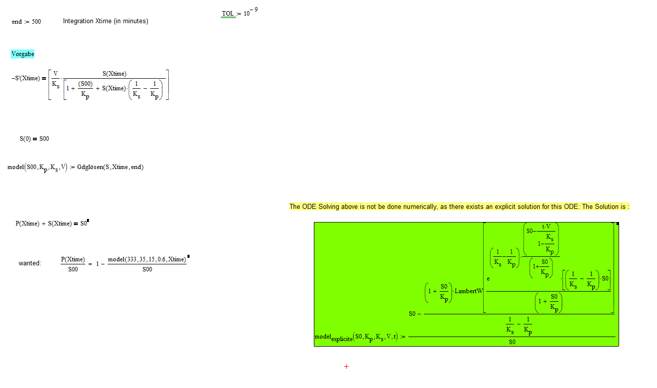

Hi Experts,
I have here an ODE which I can solve in Mathematica explicite. The Solution is in the green box. But how can I solve this ODE in MathCAD 15?
Ok; it took me a while to understand everything, but the attached now has the numerical solution giving (almost) identical results to the symbolic!
I've streamlined the syntax in places.
Alan

Not so!  Although Mathcad can't solve it symbolically. it can solve it numerically - when the Solve block is written correctly - see below.
Also, your explicit model returns 0 (actually, 10^-14) for time 0, even though you pass it an initial value of 333.  It seems your symbolic solution is not of the same equations you have written in the solve block.

Thanks a lot, ok I forgot one equation: Here the y_plot should be the same as the modelexplicite.
But I get an error that there are too many startconditions. How could you solve it on your side?

You have an unmatched bracket in the solve block (Just to the left of the 1 in the denominator).
Alan
Thanks a lot, Alan, that works but I can not fit the data. The fitting works with the MMA solution. It is strange, as the numerically solution gives the same results on some t. Would you mind telling me, what is wrong here?How_to_solve_ODE_and_FIT.gif
Alan
Dear Alan, thanks a lot!!! I see that the end integration time was not correct. I also see that you calculated the end time by a routine.
