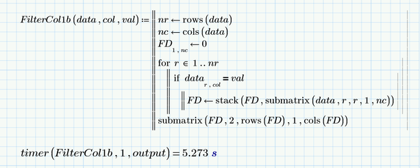

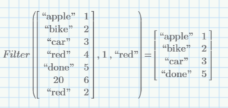

Does anyone know how to speed up MCP for processing large data sets?
I am working with a 50832x14 size data set that is output in Excel from another program. I would prefer to filter, sort, and manipulate the data in MCP vs Excel. However, trying to execute a simple filter step in MCP on a data set this large has proven impossible. I can't get the function to complete (endless spinning wheel). Whereas I can complete this one step in Excel in about 1sec.
Does anyone know how to speed this up? Or any other tricks for processing large data sets in MCP? I would really, really prefer to avoid Excel but at this point, I'll have to use it.

A matrix of that size should normally be no problem in Mathcad.
But Prime often was reported here as being very slow with larger data sets.
I guess that the "submatrix" command slows down the calculation and you may try to replace it by using the row-selector.
I guess you could replace the whole filter function by a using the built-in "lookup()" function.
BTW, what the reason behind the last step in your function - getting rid of the first row if its first entry is 0? Why the if-statement? The first row will always consist of zeros because thats how you initialize it.
Your function does not cover the case if no row is found containing the given value in the appropriate column. The attempt to get rid of the first row with the last submatrix command will throw an error because there is no row number 2.
EDIT: I gave it a try and using the row operator instead of  "stack" and "submatrix" speeds up the calculation so it takes just half the time. But using match() and trim() (not lookup() as I had written above) really significantly cuts down calculation time to less than one hundredths.
The usage of your variable "flag" is quite complicate and actually you don't need this variable at all.
Your filter function returns all data rows which do NOT contain the given value in the specified column. Is this intended?

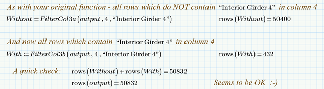

OK, her is the version using the row selector instead of stack and submatrix
And here is the one using the match and trim functions
I checked that both would return the same result as your original function (all rows NOT containing "val" in column "col".

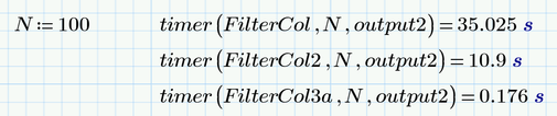

I used a smaller data matrix with just 1001 entries.
Now I used a timer function to compare calculation speed of the three functions. The values seen show the time needed (on my rather slow oldtimer) for 100 calls to the functions.
Your full original data is now processed by FilterCol3a in about 0,2 seconds.
And because I suspected that you actually wanted the function to return just the rows which actually contain the given string I added a function to do this as well
and checked if the output of both would combine to the full data set
Prime 6 worksheet attached

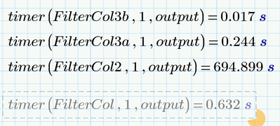

EDIT: I was curious and tried timing the full data set
As you can see this time it took FilterCol2 not 60 times longer compared to FilterCol3a, but rather nearly 3000 times longer.
I did not wait for the original FilterCol to finish for obvious reasons 😉
But I guess that even FilterCol2 would be much faster if you program it to just return the matching rows and not all rows which don't match.
EDIT2: I rewrote and streamlined your initial FilterCol() function to return only the rows which contain the given value so it does the same as my FilterCol3b. Now there are much less stack() and submatrix()  functions to execute and calc time is significantly more reasonable now (but still 300 times more than FilterCol3b)

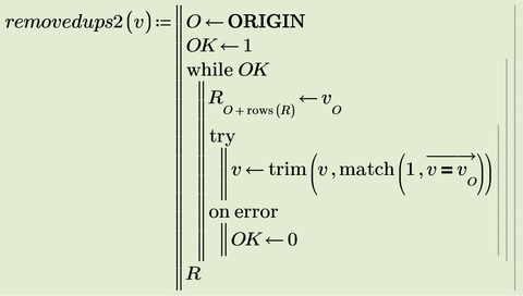

As we here have dealt with match and trim, I made up a tricky version using these functions which uses the try...on error to stop the iteration (iteration stops when trim throws an error because it would have to delete all rows in the vector):

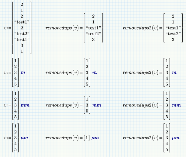

As I already had criticized here
https://community.ptc.com/t5/Mathcad/How-to-remove-duplicates-in-a-matrix-column/m-p/293717/highlight/true#M114533
using match, lookup, etc. is not very helpful if you have to deal with small numbers because of their usually too large tolerance. Often we don't realize that we deal with small numbers when we use units like micrometer, but Mathcad (and Prime, too) converts all values to the base units which then results in small numbers.
This of course is also true with the function I just posted:
removedups should not remove anything in any of the three cases, but ...
(To:Werner_E)
This small modification should do the job.
Still using "match", but this time match() only has to distinguish between 0 and 1 which it does flawlessly 😉

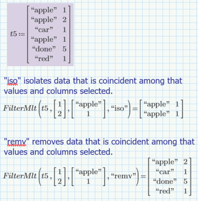

Hi @Werner_E  wondering if you have any recommendations for the below. I tried to take your filter recommendations and expand that into a function that can filter a data set based on multiple criteria in multiple columns (i.e., like one can in Excel using data filters). Additionally, I find the 'isolate' or 'remove' options useful depending on what I need to do w/ the data.
I came up with a solution, but again, it is too slow for working with large data sets! Couldn't get a result in the end...

(To:Andy_C)
Give the attached version a try with a larger data set. I am not sure if it would perform OK as of the large vector "mask" (as many rows as the data set itself) which is used.

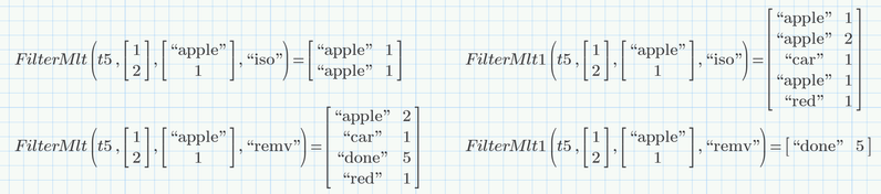

I should have mentioned this use case in my first example, but is it possible to modify this to also allow for two filter criteria to be in the same column? I tried (1), [1], and {1,1] column variations paired with two vals but the logic isn't there I guess. The use is to be able to isolate multiple data lines in the same column at once vs taking several filter steps I suppose.
Thanks again!!
(To:Andy_C)
Thats easy, simply initialize "mask" with zeros and use an OR instead of the AND.
But of course the function is now also returning different results with your initial examples compared to the original function you had posted:
You could add an additional argument (like the "type" argument you added) which decides if the multiple conditions should be ANDed or ORed.  I would chose a similar approach as I had sketched in the worksheet - choosing one of the two option as default which is effect no matter what the argument is and choosing the other option only if a specific argument value is passed.
And I also would suggest that you also save include text description (function documentation) along with this utility function as its very likely that, if you are like me, you forget about the correct usage of this multi-argument function 😉
(To:Werner_E)
Attached is a suggestion for a function with the aforementioned additional argument to choose between OR and AND.
Defaults are "iso" and "AND" if you provide an invalid argument.
I also got rid of the different initialisation of "mask" with 1's or zeros by initializing with the first actual mask given by "col" and "val".
I would expect performance of the function to slow down a bit because of  the calls to the "maskFunc" function.
(To:Werner_E)
Here I have added FilterMlt3(). This function automatically selects between AND and OR.
If the column number of a condition is equal to that of the predecessor, OR is chosen, otherwise AND.
EDIT: Use this function with care as it might not always give you the results you expect!
Reason: If, lets say b and c are conditions concerning the same column and should be ORed, and a and d are conditons for different columns, the functions calculates
a AND b OR c AND d
but it should calculate
a AND (b OR c) AND d.
