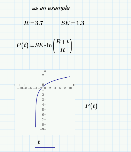

 how to write this variable in PTC Mathcad prime?
17 REPLIES 17
Screenshot_1.pngas an example
(To:ptc-3873503)
In Prime, log(x) alone stands for the decimal logarithm – unfortunately, because this does not comply with the standard and should actually be lg(x). Of course, you could also define the function yourself -> lg(x):=log(x)
In other programs, log(x) often stands for the natural logarithm, which is no better, because it should be denoted by ln(x).
Prime supports ln(x) but also logarithms to any base, because the log function can also be used with a second function argument, the logarithm base.
So you could also write the natural logarithm as log(x,e), analogous to the general notation in your image. But why would you do that when you have the ln function ready to use?
