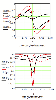

The plots at the end use a title label which is not supported by Primes native plots. You will have to use a manually placed text region as a substitute. Furthermore Primes plots do not offer the option to add grid lines. Workarounds to create grids as part of the plots where posted here in the forum now and then.
Or you recreate the plots with the chart component. It supports amongst other features labels and grid lines, but unfortunately has its own serious disadvantages, too.But you may give it a try.
Mathcad:
Prime:
