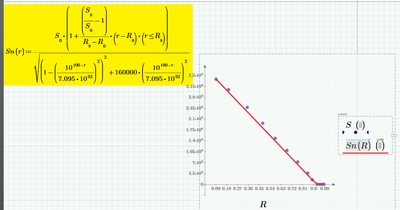

Can you show me one formula for this points? The Mathcad 15 sheet is in attach!
Thank you!

Look at the attached sheet.
This RKD is nothing special - its an ordinary polynomial fit.
You could use polyfit as well! Same result!
It may be that d,k,b.i have special meanings in economics but we can happily get rid of them without altering the resulting curve.
And your observation concerning d and k seems correct. The economics play with 14 parameters for an 6th degree function while only 7 are necessary. So any change in one variable can easily be compensated by others.
As so often, economists invent high-sounding fancy names for quite basic elementary mathematics 😉
EDIT: changed sheet to show the polyfit gets the same result 😉

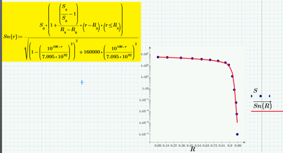

In your initial post you show a plot with the y-axis log scaled. Is this what you need?
Then you have to be aware that the quite interesting solution of DJF will only give you what you need for the first part of your data, similar to what Terry had provided. You would need another function for the second part!
Guess you attached that log-scaled pic to show that you don't like that bumpy look when using linear interpolation, right?
So why not use linear interpolation of the logarithmized data. This should be easy enough to implement in C++ even though its not one single function equation.
You may also use splines, but I guess there's no benefit doing so and its quite a bit more work to implement in C++.

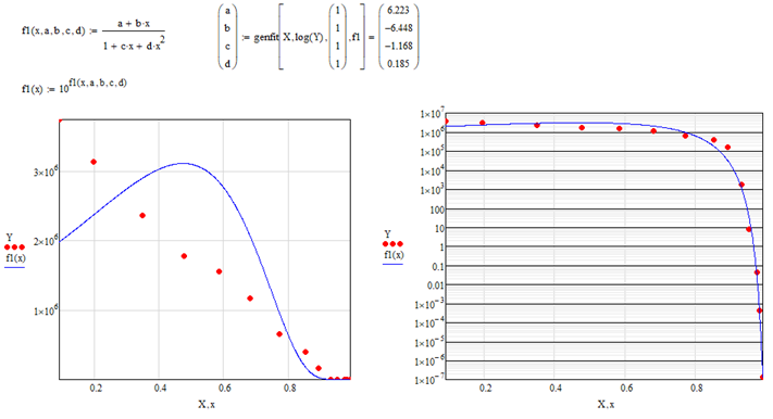

B2.pngHere is an example that a fit (a regression in that case, not an interpolation) which looks quite OK with log-scaled axis, is horrible when plotted without log-scaling.
log plotlog plotlinear plotlinear plotdoes not go negative

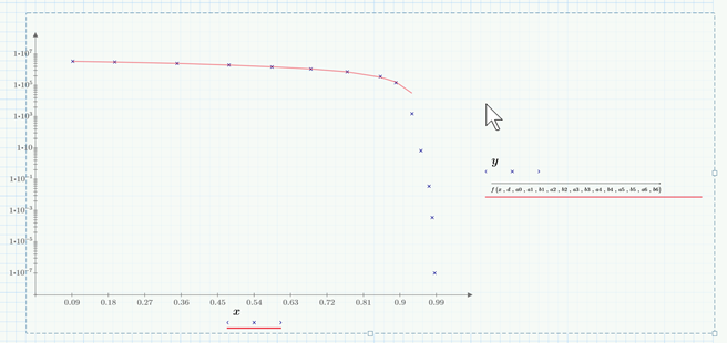

I felt we never got a great solution to this one so I've poked at it occasionally.  Here's an approach that uses Butterworth filters to allow the combination of 3 unique curve fits.  Still not perfect, but an interesting approach to have in your toolkit.  The filters multiply the various fits by a square wave (~1 or 0) to turn them on or off as we progress along the X axis.  In the end it's not much different than Fred's approach, but can help smooth the transitions.
4.0 attached.
