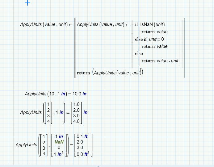

Something like this:
Here's one way to then extract each of the individual variables with their units:
This is the kind of situation where I'd almost certainly write a function to simplify things and make the worksheet easier to read (and, hopefully, debug / maintain).
In Prime, you'd replace the clumsy transpose/column-operator with just a row-operator (Mathcad 15 has no row operator and I don't have Prime available).
(In this instance, as there is only likely to be one AISC table, it would probably be OK to write the function such that it picks up AISC from the worksheet rather than passing it as a parameter.  The advantage of doing this is that it potentially makes the function less confusing to the reader.  In reality, I'd probably still define it as getLabel(AISC, label))
Stuart
tslewis
(To:MJG)
This is an elegant solution for applyign units.
One thing I found out, you can create local functions within functions, see below, pretty powerful

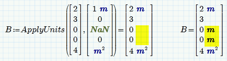

One problem:
tslewis
(To:Werner_E)
What is the issue? I don't want to apply units if the value is not intended to have a dimension. What if the value is NaN, a string or a complex number? How did you end up with units of m? Did you add those manual in the result ?
(To:tslewis)
No, I didn't add anything manualy.
You can give it a try yourself, but be sure to use the value 0 where i had done so.
Explanation for this behaviour can be found in the thread Io referred to.
tslewis
(To:Werner_E)
Aha - that is interesting, thank you for the tip!
