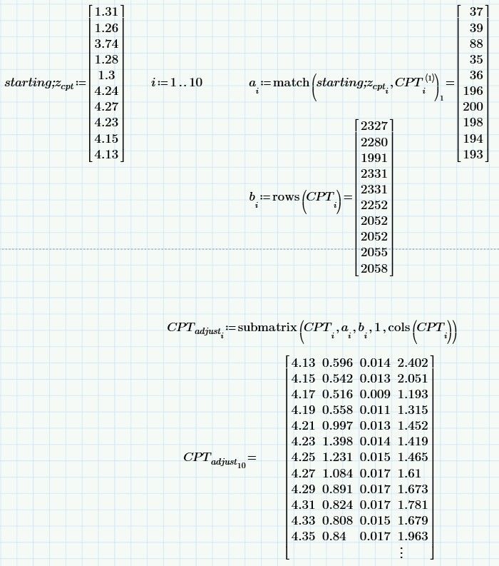

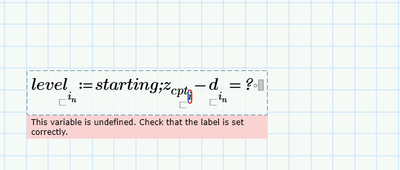

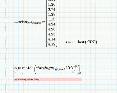

why I having this error , did I write it wrongly?

match as a function by default looks for equal values {you can change this}. This means the depth must be in the CPT to get a match.
I have changed some of your start values to match values in the CPT's. 4.27 for 4.26, 4.15 for 4.14, 4.13 for 4.12.

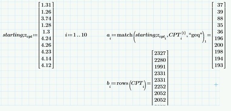

If you wish to keep starting;z subscript cpt.pos as the values you have that do not appear in CPT's you can add the "geq" greater than or equal in the match function.

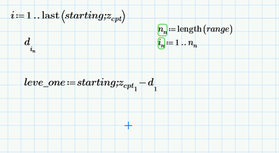

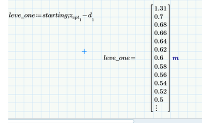

terry can you please help me fix this equation ... It will be more accurate if I just substruct them ..

subscript for two values is i subscript n, one is just i
One other correction I made is to add range_5 to definition of range it was missing. In your sheet range only has nine entries.

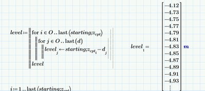

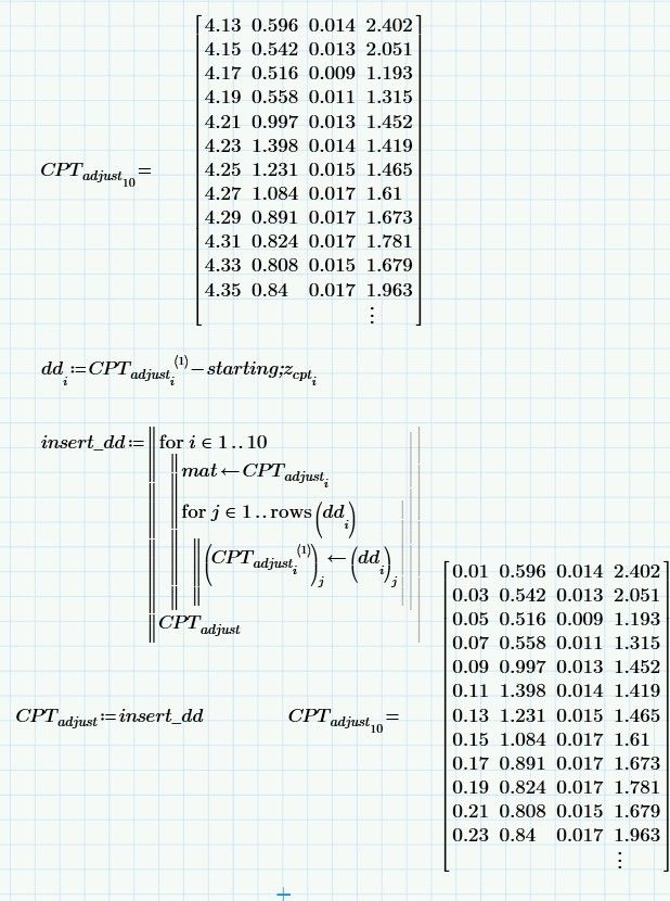

See what I need is something like this forumla : the first start point from the first d ... so it loops twice .. and I should get this answer
I wrote a program , and I get these wrong answer:
can you help fix the program ?

What is the correct output expected?
- Mark as New
- Bookmark
- Subscribe
- Mute
- Subscribe to RSS Feed
- Permalink
- Notify Moderator

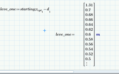

Like this one

In your sheet range is missing range_5. I added it. range in your sheet has nine entries
two values have index values i subscript n and one has index i use same index for all

Not sure but are you looking for something like shown in the attached file?
I prefer programmed for loops over worksheet range variables...
