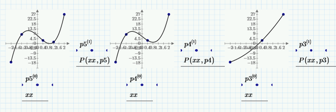

As this is obviously homework you should show your attempts for a solution. This also would help us to see where you have problems with the handling of Prime so we can help.
If you already derived a solution you may check your function by creating a plot and also check against the built-in "polyfit" function:
