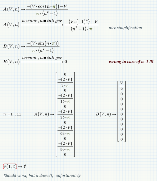

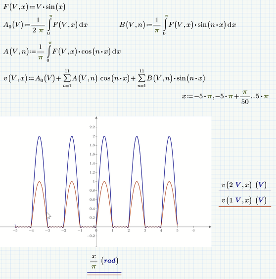

For more versatility I would make the peak voltage V an argument of all functions involved:
You don't need symbolical evaluation for plotting, but of course you could inspect the values of the coefficients that way:
If the last symbolic representation is important for you, you may try to define A1 and B1 separately like A0 and let the sum beginning from n=2.
Prime 6 sheet attached
I want to ask why doesn't it work when v(1,t) and it gives the wrong answer when symbolic arrow is used for B(n) it ends up giving zero? Are these limitations in the software like we discussed previously?
(To:AS_9824434)
I don't know why the symbolics behave like it does. Sometimes we find a workaround for a problem or limitation, sometimes we don't.
But wrong results as given by the new symbolic in Prime 6 and later versions sure are not limitations but severe bugs.
