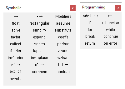

3. There is no option to UNDOCK the menu in MP10. In M15, you can undock the function so that it is always open. In M15, say I do Programming, I can Add Line, do if, assign value <-, do for, with just 4 mouse click. With MP10, it will take 8 mouse clicks. Would be good if Mathcad Prime can have the option to UNDOCK menu.

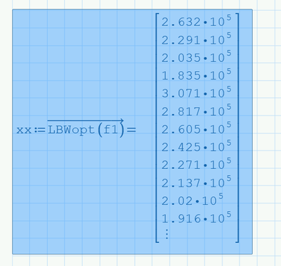

5. To move selected item, you have to place the mouse cursor slightly outside the selected item, and the region is narrow. This is for MP10. It is slow, since you have to move your mouse, and then place it accurately. In M15, you can place the mouse cursor anywhere on the selected items, and drag it. In MP10, if I place my cursor on the BLUE selected region, then I could not drag the block.

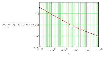

To add grid lines you have two options:

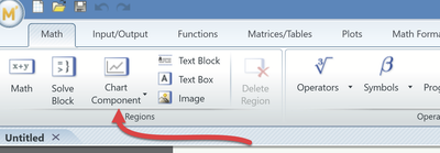

1) Use the Chart component (a badly integrated third party module) instead of Primes native plot. You will get grid lines, labels, a secondary y axis, .... But be aware that this component also has severe drawbacks. It does not support units, does not scale with the Windows zoom factor set and is VERY slow and awkward to use.
2) Use a user defined function which creates an additional plot trace which draws grid lines. LucMeekes and also I have posted such functions here in in the forum in the past - you should be able to search for the appropriate threads here and hopefully also find 'em.
I posted my version here   Solved: Re: In MCD Prime 4.0 is there any way to add grid
Luc posted a version which also works in Prime Express. Think it was here: Solved: Graph how this derive ?

Thanks @ttokoro . What I meant is the lines shown below. this is plot from M15.
