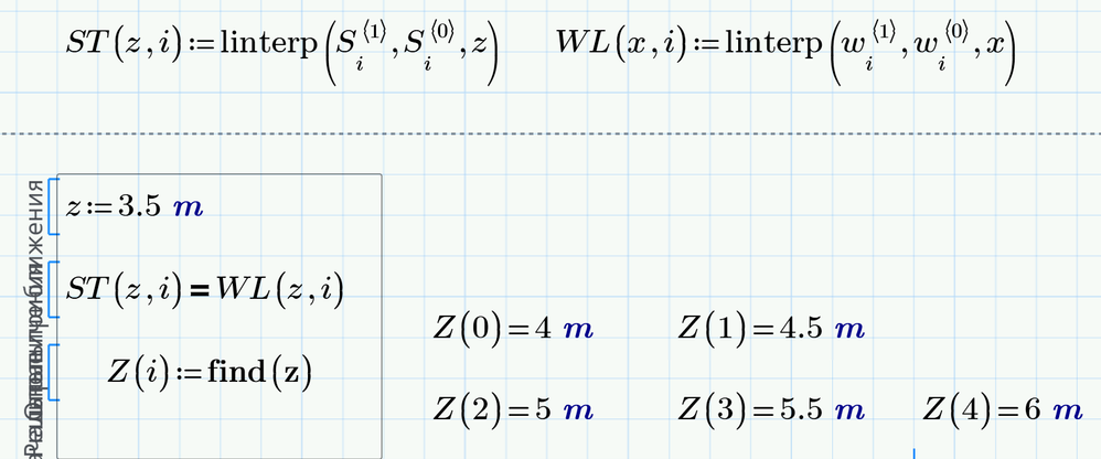

I am using MC Prime 3. I am trying to see if it is possible to interpret various points using indexes as per the attached.
Basically I have defined various matrixes and interpreted lines between them as a function of z. Then I have used solve blocks to find the z value when the two lines interpreted from my matrixes meet. However, as I am doing many iterations of the same thing I want to know if it is possible using indexes or if there is a better approach? I have never got into MC Programming but guess that might be an approach?

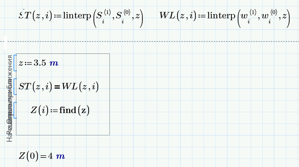

See if the attached file helps!

That is really interesting! I think that solves my initial problem. as outline. Could you take this a step further. Where I want to interpolate ST with the WL values but I have multiple sets of WL as the attached.

In Prime 4 all ok. In Prime 3.1 I have your error.

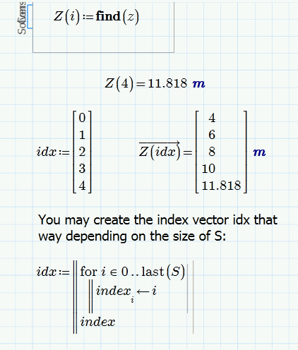

Anyway - could it be that you are just looking for something like the following?
Or
idx:=  0 . . last(S)

Try this
@Fred_Kohlhepp wrote:
Or
idx:=  0 . . last(S)

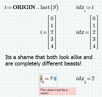

No. A range won't work OK as you can't access the result. You can't assign the output to a variable.
So idx has to be a vector.
But of course we do not have to resort to a program to create it.
We could use an auxiliary range

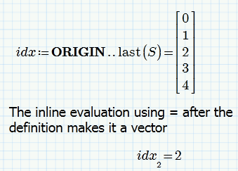

or we can use the undocumented trick with the inline evaluation

Undocumented :  entirely true, for Mcd15 too.
So, same behavior in Mcd15. Just placing an inline = after the definition of a range variable makes it no more usable for working with, e.g. for retrieving elements of vectors and operate with them in the subsequent part of the worksheet.
That seems to me not being consistent with the usage of the inline = with other type of variables, since in the case of range variables it completely changes their significance.
Just putting an inline = after such definition made the rest of my worksheet of about 30 pages full of errors and to spend one hour to (re)discover the reason why. I initially thought  that's a kind of a bug, but it appears it isn't....
Therefore, users, take care with this inline = with indexes !

I don't think Mathsoft ever intended us to put an in-line equals after a range variable.  (I'm not sure when the in-line equals became possible.)  I'm a  little surprised it doesn't throw an immediate error after a range variable.
Think of it as "Here's an in-line equal.  They must mean they wanted a vector, not a range variable. . ."  And, since it got converted to a vector, unless you index it you are referring to the whole thing, so if it's positioned as an index Mathcad can't figure out which element of the vector you wanted.
