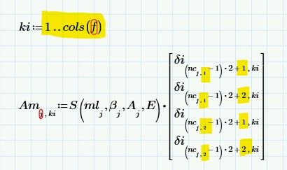

Hello Terry,
I tried to change your sheet's origin from zero to 1. I succeeded in making the changes in most section .However, I was not able to do it in the section where you compute the member forces and the following sections. Would you like me to start a new thread or post? i have prime 10.
Thanks for your assistance!
Sam
Hi Sam,
No need to start a new thread we can user this one.
Please upload your worksheet and I'll have a look.
I have a habit since early days of COBOL and C++ of using zero as base of indices into arrays and am so used to it. I have a habit of not ORIGIN proofing my sheets so you can use 1 or 0. Can understand you want to change to 1 based.
Cheers
Terry
Hi Sam
Like this:-
Changes in yellow.
