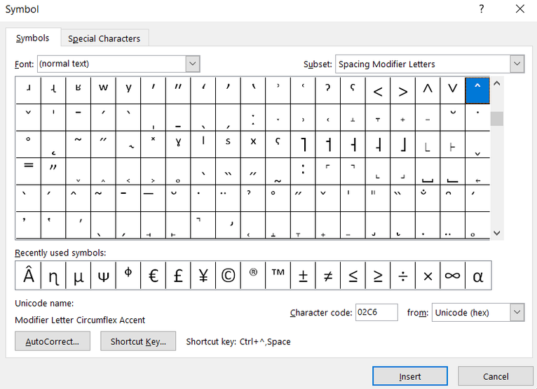

Open Character Map and select Advanced view.
Select the base character and copy
Look for "Group by:" and select Unicode Subrange is the drop down box
A window will appear in the upper right.  Scroll down to "Combining Diacritical Marks".  Select the mark you like and select and copy.
Now you can paste into a Prime Test Box.

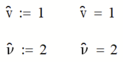

But if I want to insert v hat for example:
How could it be done? that I did not see the letter v hat...or I omit it by mistake (I do not know:))

To create something like this
first follow the description of @tietjee
Start "charmap", chose "Group by. Unicode subrange" and select ""Combining Diacritical Marks" in the windows which popped up.
Now select the diacritic character you want to combine with the letter v or ny - in our case the third one in the first row, the accent circumflex. Click "Select" and "Copy" to get it into the clipboard.
Now switch to Mathcad, type v, then Ctrl-C to insert the "hat" and then : or whatever.
Keep in mind that even though the hat is on top of the letter v, the logic is that its to the right of this letter. Put the blue cursor to the left of the combined and then press the right arrow. The cursor is now (without you seein it) between the "v" and the hat "^". If you keep on typing now, the hat will move along, so you rather have to press the right arrow a second time to place the cursor to the right of the hat, too.

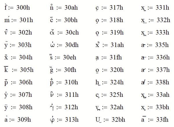

Here is a selection of diacritic characters
Mathcad 15 file is attached.

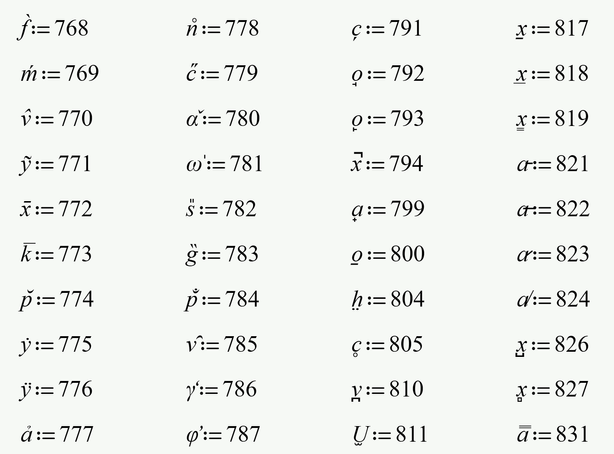

I also converted the sheet to Prime and the result is much prettier (Prime doesn't support the hex notation of numbers, though). But some characters seem to be displaced in Prime - not sure if its the fault of the converter.
Prime 6 sheet attached, too.
