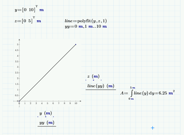

Hello to all,
I am looking to see if you can tell MathCAD to integrate not along the x axis by along the y axis.
In the attached I am trying to integrate the area above the plotted line i.e. from 0m upward to 5m integrating all the values of x in terms of y as opposed to the default which is to integrate under the line all the values of y in terms of x. There is madness to the logic as to why I want to do this I promise.
If I can get this to work the answer should obviously be 25m^2.

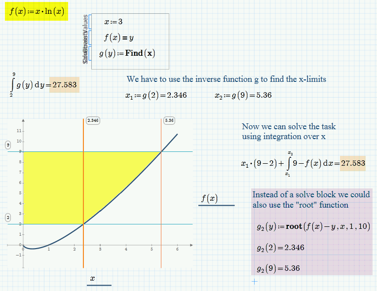

Don't blame the solver!

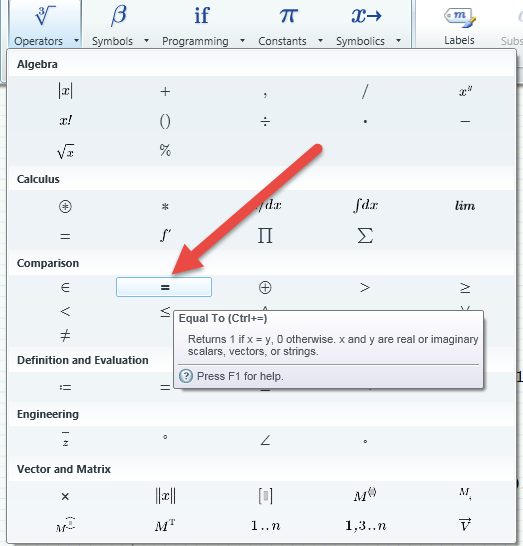

You used an assignment (f(x):=y) in the solve block constraint but you must use a boolean equal sign (the big fat =).

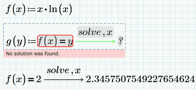

Here is an example where you can't find the inverese function in an exact analytical way.

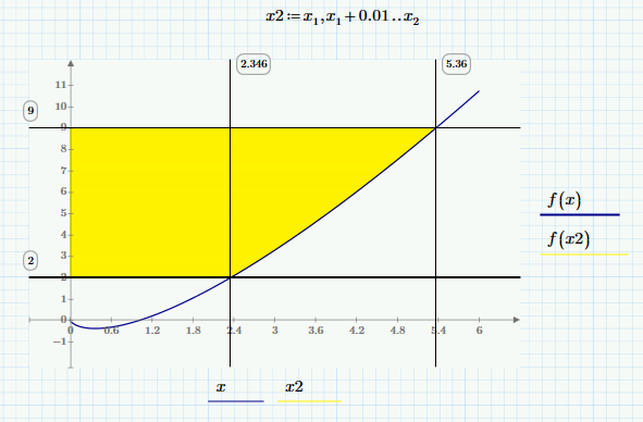

And even when you try to find the yelllow area using integration over x, you need the inverse to find the x-limits (the same is true for your example, but there the limits where quite obvious).
The picture also shows a way to use the root function to define the inverse.

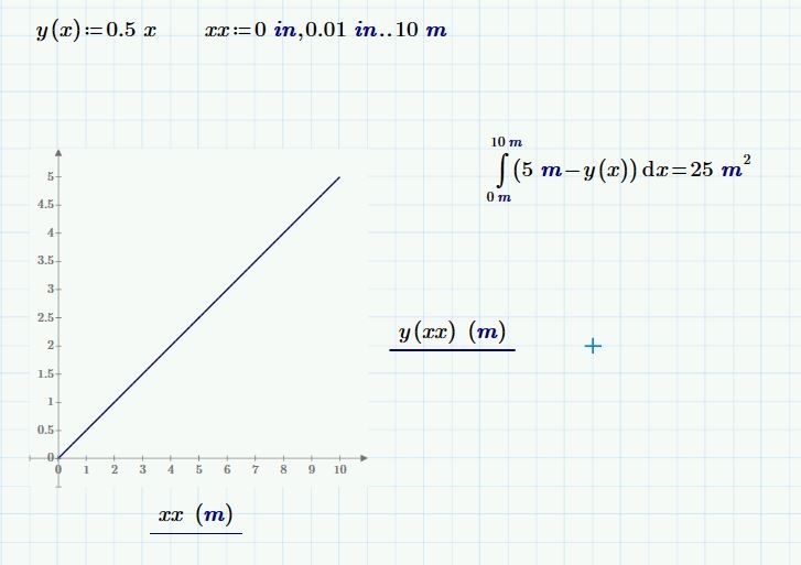

First, you need to integrate from 0 to 10 meters.
Second, your integral computes the area below the line.  The area above the line is the integral of 5 - line(y)

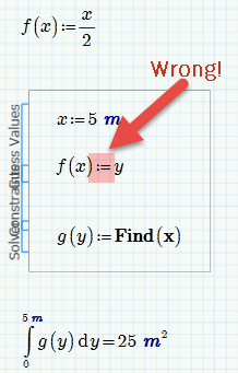

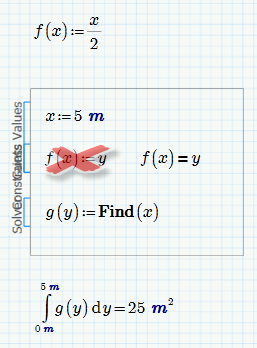

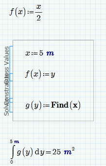

Here you are:
Your function should better be injective for this to work 😉
EDIT: In the first place I had used a pic with an assignment := instead of the correct Boolean =.
To avoid confusion I just replaced the pic.

I see that that yeilds the correct outcome but not sure I follow the solve block.
Why is the guess value of x 5?
I get that the function of the line in terms of y is half of x as when x is 10, y is 5.
So that is logical that the function for is x/2.
But I am lost when you get to the guess value and constraint also why the new function g is to find x?
Sorry for being dim witted...
(To:awibroe)
Its overkill to find the inverse of a linear function using a solve block. I was just demonstrating this assuming you may want to use a more complicated function later.
I have chosen 5 as guess as ist the center of the interval we a dealing with. In case of this simple function an any value will do OK.
The inverse function which I call g is a function which assigns a given value of y the appropriate value of x so that f(x)=y. thats exactly what the constraint in the solve block says.
in case of your linear function f: y=x/2 the inverse of course is g: x=2*y.
We sure would not need a solve block for this 😉

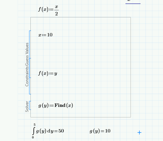

I totally agree with that and see that if you indeed define the graph in the inverse I actually get what I am after i.e. the x axis has to be the function. Think that is the underlying anwer I wanted.
What I am really intrigued by is the solve block approach which when tested I am not sure of.
If you change the guess value this puts the whole thing off and if you recall g(y) it gives a constant of the guess value?Capture.PNG

I feel like the solver should be being asked to find the inverse of x not x?
(To:awibroe)

The 9 (y=9) is the top limit of the shaded area in my example (its was y=5 in yours). Integration over x would give me just the area below the curve, butr we want the area between y=9 and y=f(x), so we need to integrate the difference of the two.
You can write your own shading or hatching routines in Prime, but I simply edited the screenshot using the fill tool my capture program provides.

(To:awibroe)
@awibroe wrote:
My mind is obviously running away with me here but I'm interested as to why Find x is the solver for g(y)?
Maybe you are used to day that for the inverse function you have to switch x and y and then solve for y.
I simply omitted the switch and just solved for x.
You can formulate the solve block also lke this
Guess: y=5m
             f(y) = x
             g(x) = Find (y)
The name of formal function arguments don't matter. You may also use
Guess: a=5m
             f(b) = a
             g(a) = Find (b)
and it would work the very same way 😉

You can plot g like any other function, but as a solve block or also the root function just is using numerical methods, you can't get an analytical function term.
You would have to use the symbolics to achieve that. But with my example f(x)=x*ln(x) there is no analytical expression for the inverse - it cannot be shown using standard math functions and so consequently the symbolics fails. As you can see in the last line its still able to provide numerical values for specific values of y.

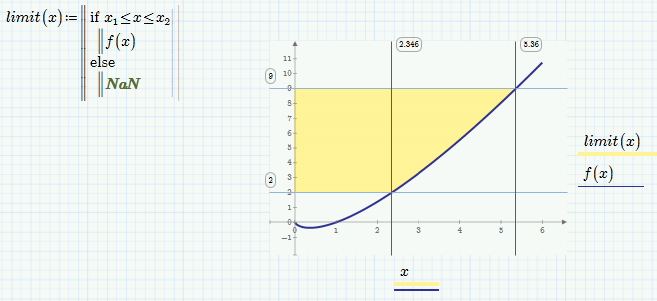

DJF
(To:Werner_E)
Werner, I'm curious how you shaded the graph.  I have some experience in this but can't do what you did.  I can't get a Bar Trace to work between two Y values.  And I can plot lots of dots into the necessary area - but I have to add a routine and additional traces to the plot - which it doesn't look like you did.  So, you've stumped me.
(To:DJF)

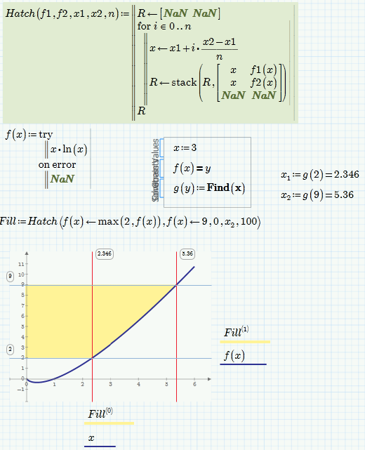

I am sad that I will have to disappoint you. While there are quite some ways to program a hatch or fill function to simulate a shading between two curves (usually by creating a lot of more or less narrow spaced vertical line segments, basically the output will be an n x 2 matrix) in this case I simply used the painting capabilities of my screenshot software to fill the areas in yellow 😉
DJF
(To:Werner_E)
Thanks for the reply.  In case anyone else is curious, the best technique I found for this case is as follows.  Plot a 2nd graph (over a range of x_1 to x_2) and change the plot type to Bar Trace.2017-09-05_12-22-44.png
(To:DJF)
Better than dots are lines, I think (less data but better fill).
In case of the plot in question the yellow shading could also be done using Primes horizontal bars plot:
But of course both mean an additional trace.
Here is the version with the bars:
and here a more general routine which can hatch/shade an area between to graphs in a given interval:
EDIT: Just see that in the meantime you had posted your version of the shading with bars using range variables to limit the plot instead of a new function like I did.
