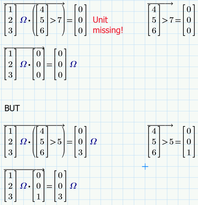

Is there a known explanation for the next? I would think that the resulting units should be the same, but apparently not.
This was with Prime 7.

I agree that its a very inconsistent behaviour.
As Prime is not using SUC (static unit check) is should always apply a unit to zero values.
Example done in Prime 9
You may consider reporting it to PTC support.

Thanks!  I suppose I will. Especially as it seems to persist in newer versions. It seems to work as long as at least one of the boolean rows returns true.

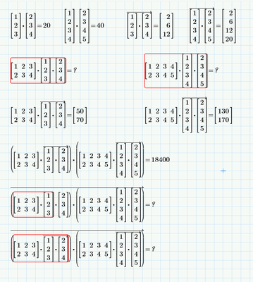

About the vectorization: Was it always so? I seem to recall that at some time I needed it to get the result, but it is too long ago to dig up.

As far as I am aware multiple vectorizations never had any effect in Mathcad, but then my memory can also be wrong ...

You seem to be right - at least the multiple vectorization doesn't seem to work as one would hope. 🙂 The location of the vectorization does matter, though.
