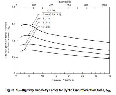

I would like to ask if it is possible to interpolate a value between 2 plots or more as shown in the picture. For example, I want to get value of GHh for H=1.5 m and dimeter 6 in.

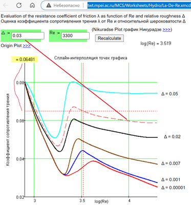

See please. It is good for you?
Moscow Power Engineering Institute: Mathcad Calculation Server (mpei.ac.ru)
See the picture too

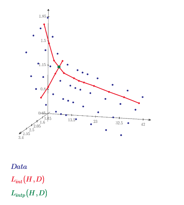

One more interesting f(x, y) interpolation - the price of an old car
Sorry, but i didn't understand how you did it.
Thanks for your help, it worked finally.
