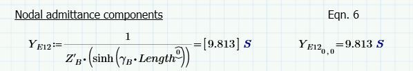

Inverting a matrix
I am trying to invert a matrix using the variable names already declared. I can invert the matrix if I manually enter the values of the variables, but not using the variable names.
I am obviously missing something and would be grateful for any guidance towards resolving the issue.
I attach the entire worksheet but I am only interested in comments on step 5 where the matrix manipulation appears. I have left notes on the draft section of the page to show what the variable values are and what the problem is.

This was subtle.
Back in sections 3, the results for the Y's are actually a matrix with one element not a single numeric result.
The same occurs for the Node values in step 4. The answer is a 1 x 1 matrix.
For instance:-
One is a 1x1 matrix as indicated by the square brackets. The other is a single numeric result.
Your file Admittance was a matrix made up of nested 1x1 matrices and could not be inverted. But your B matrix that had just the values not the nested form works.
Correct file enclosed.

The reason for you problem is that the elements you put in your Admittance matrix (A[0,4, etc) are not scalars but 1x1 matrices.
The reason for this is that you use the row operator to access the elements of the vector "length" instead of the vector index like "length[0".
If you fix this the inverse matrix calculates without problems. See attached.

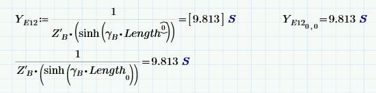

The point is, that Primes column- or row-selectors (ctr-shift-c, ctrl-shift-r) always return a matrix, a column resp. a row vector. Thats true even when its just a 1x1 vector/matrix.
To access the element of a vector or matrix you have to use indices, either v[i or M[i,j

Hi a postscript.
I should show you how to correct the equations to make it simpler.
The first equation takes the first row of Length as a matrix and returns a matrix,
The second equation takes a value from the first element of Length and returns it as a value
Cheers
