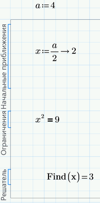

Is it an error in Prime?
ValeryOchkov
6 REPLIES 6
If you ask PTC you probably would hear that Its not bug, but a feature. 😉
I wouldn't call it a bug but a rather a quite senseless limitation of Prime. Prime, because of the evaluation equality sign, identifies a condition and then realizes that it is not..
Of course you may call it a bug, too, as I can't think of a situation where this behavior would be beneficial.
As fortunately we don't experience this behavior in Mathcad 15 we sure can say that is it at least a deterioration.
But
Yes, a solve block is pure numerics and obviously immune against symbolics. In Prime, we can not even evaluate Find (x) symbolically - another step backwards.
I don't see what's wrong with this. the assigment of a/2 to x is just setting the guess value.
I would be very surprised if in this case the result of the Find() would have been 2, given the constraint that x^2=9.

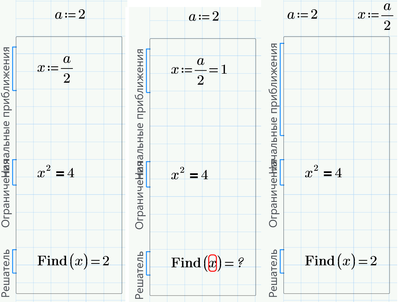

The problem is not the result 2, but the problem is the solve block failing when the assignment of the guess value is followed by a numeric evaluation equal sign as shown in Valerys first post. A symbolic evaluation after the assignment does not result in an error - thats what Valery tried to point at.

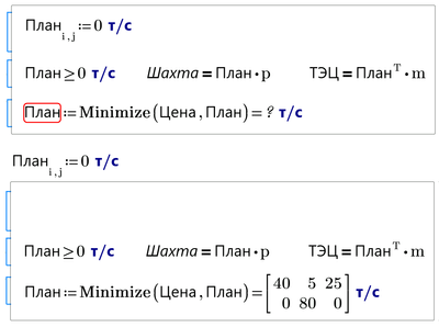

The problem showed up in this thread
https://community.ptc.com/t5/PTC-Mathcad/Solve-block-error-quot-Not-a-valid-constraint-quot/m-p/630689/highlight/true#M187479
I wasn't aware of that problem in Prime, too, until I traced back the error in that thread and landed at this inline evaluation.
But it is one bug of Prime on 100%
