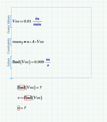

Is it not possible to evaluate the solver after solve block?
I am unable to evaluate the variable used in solve block to use after solver also tried to assign it to diffrent variable and then evaluate the results is same not working

See what happens if you change the expression inside the solver to:
Voz :=  find(Voz)
and below the solve block:
Voz =
