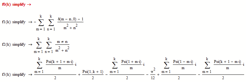

It seems to me that you used the result of your first region when defining your function f(k). But why didn't you have used this result as it is by copy and paste - why did you reTYPE it? And why didn't you simply use the symbolic result in defining f(k) like
Obviously you have this expression in mind but want to exclude the terms where m=n.

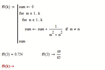

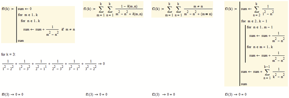

Various ways to define this function come to my mind.
Most obvious is using a program with two nested loops
But because we are using an if-statement, the symbolics chokes on it.
We could use the Kronecker delta
a Boolean expression
or simply subtract the unwanted summands
f3 is way faster when it comes to numerical evaluation and all but f0 can also be 'simplified' symbolically.
But none would simplify in a way to give a meaningful result when used in the limit expression.

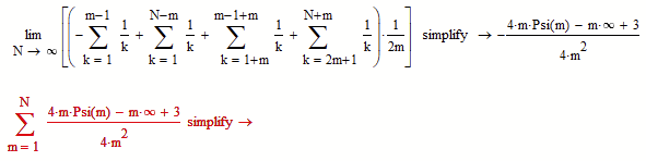

I wonder about step #9 and the summand - 3/(4 m^2) which, at the end, is responsible for the non-zero result.
In my attempts I also used parfrac and ended up with an expression containing the 3/(4 m^2) as well, but because this expression also contained an infinite sign, it could not be used for further calculations
I've changed the text between #3 and #4. I should have copied more carefully from my pile of paper. Regarding your question #9:
"Der ursprüngliche Summand und #2 sind daher identisch mit #3. Darstellung der Summe über n als Differenz zweier harmonischer Summen, eine summiert bis N+m und die zweite summiert bis N-m.
Umformung ergibt:
sum(1/(m^2-n^2)(1 bis N) = -1/(2*m)*sum((1/(n-m)-1/(n+m))(1 bis N) = 1/(2*m)*{sum(1/k)[1 bis N+m]-sum(1/k)[1 bis N-m]}-3/(4*m^2)
Dazu Auswertung des letzten Terms durch Nebenrechnung in #21 und #22. Zu beachten ist, daß die obere Summationsgrenze durch Wahl des "neutralen" Summanden 1/k angepaßt werden muß und zu N+m bzw. N-m wird:"

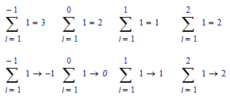

Das Problem bei Mathcad 14/15 ist, dass der Summationsoperator nicht gemäß der mathematischen Definition implementiert ist und auch Werte ungleich Null liefert, wenn der obere Summationsindex kleiner ist als der untere.
In MC14/15 agieren Numerik und Symbolik gleich, in MC11 agiert die Symbolik anders, wie @LucMeekes  gezeigt hat.+

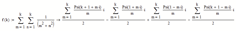

OK. First check some properties of Mathcad 11:
to see that the symbolic processor handles funny summation limits differently.
With this we can write the function as:
thus omitting the case where m=n for symbolic evaluations.
Now for k=1 through 25 we get:
But as of k=26:
and the list grows as k increases. The small thin line below here contains f(333):

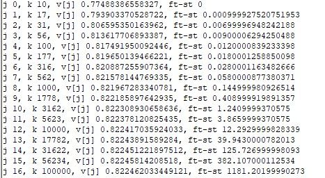

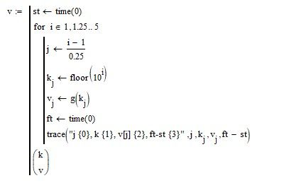

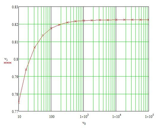

Not using symbolics but number crunching by brute force gets limit ~ 0.8225
Capture.JPGThis is function 3 by Werner
A short program to work it up
Gets this after a very long wait.
Or graphically

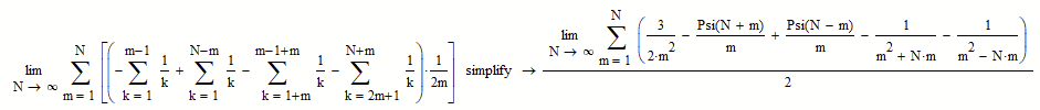

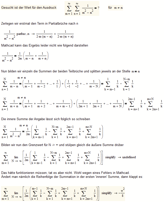

OK, hier nun der etwas sauberere Anschrieb - diesmal ohne Vorzeichenfehler.
Schade nur, dass Mathcad den intuitiven direkten Ansatz für die Summen, wie zB
nicht verwenden kann und man daher auf die Substitution k=m-n zurückgreifen muss
Und dann war es auch noch nötig gerade bei dieser Summe die Summationsreihenfolge zu ändern,
damit Mathcad letztlich ein Endergebnis ausspuckt.
Da ist in Summe doch unbefriedigend viel Handarbeit und Probieren nötig gewesen 😞
Aber wenigsten hat, wie oben schon beschrieben, die nichtmathematische Implementierung des Summenoperators nicht auch noch in die Suppe gespuckt.
Hier die Herleitung, wobei durch die PBZ und das Bilden der einzelnen Summen aber die ursprünglich vorgegebene Reihenfolge der Summation verändert wurde!
