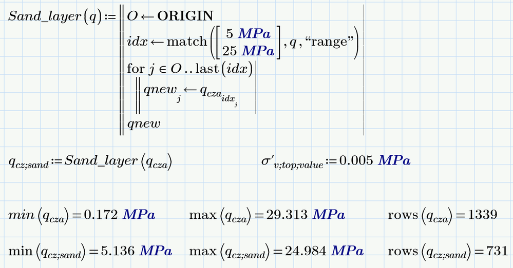

I  want the values of qcsand to be only between 5 and 25
I how to fix that
(To:YA_10963798)
So what should happen with the values in q which are outside the limits?
Do want to set them to the lowest or hightest value allowed or do you rather want to delete them from the vector?
From the attempt you posted I looks like you want to delete those values.
One way to achieve this is

YA_10963798
(To:Werner_E)
I want to delete the values outside the limits
Thanks a lot

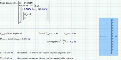

YA_10963798
(To:Werner_E)
Can you help with this one as well
I want d to start from the values that are not zero where the sand layer starts , I want to eliminate all the values which are equal to zero
d is the depth of the qc

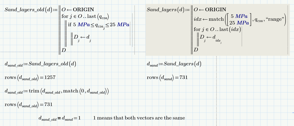

(To:YA_10963798)
Aren't you trying to do the very same thing as we already have done before - eliminating all values which are not within the range from 5 MPa to 25 MPa ???
Ahh, I see - this time you are trying to get a vector of the corresponding d-values instead!
We you could use a slightly modified version of the function above to do the job. Not sure if its a good idea to use the same name for both functions, though.
I renamed your approach which replaced the anwanted values by zeros to Sand_layers_old and showed how you can trim the zeros from the output of your function.

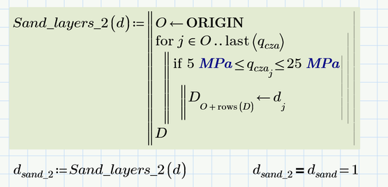

Yet even another way to do the job is
YA_10963798
(To:Werner_E)
Yes exactly,
Thank you
