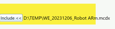

Is it possible to locate a reference file in the right margin of the document?  The intent is to utilize the reference information in calculations but not show as part of the printed document.
An alternative seems to be including the reference file in a collapsed area; however, that results in a solid line across the page when printed.  If this is the best option to include but hide a reference file, is it possible to disable printing of this region?  Again, I'm not wanting this line visible when printing formal presentation documents.  In Mathcad 15, I could turn of the time line, date, etc. and then highlight the region with a light color that wasn't visible on the printed document.

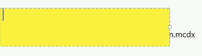

I experimented and succeeded to overlay the offending reference by a text field (of course the high light color should be chosen to be white)
but as soon as the text field loses the focus, the reference shines through 😞

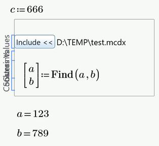

Another idea which failed was to put the include reference inside a solve block (the method could be used to provide he guess values from another file). This worked and the solve block could be moved into the non-printed area, but the definitions in the included file only are valid within the solve block - so no solution again:-(
At least its not a general purpose solution. If the included worksheet is only used to return a few values, maybe base on values in the main sheet, this method can be made to work.
In the following example the referenced worksheet defines a:=123 and b:=a+c and it works as expected, using the value of c defined in the main sheet. The solve block could be moved to the right, out of the way, but there will be a gap between the definition of c and the evaluation of a.
But this method won't work if the referenced worksheet is supposed to provide a function, for example.
