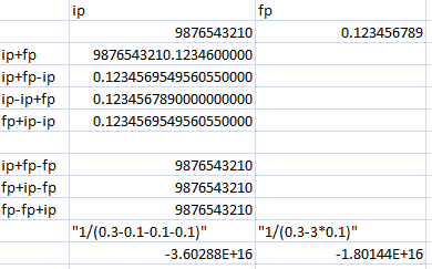

Both Mathcad and Excel make it easy to generate numerical results with floating point error.  For example, try calculating 1/(0.3-0.1-0.1-0.1) in Mathcad and Excel (you'll get a surprising result).
You need a full computer algebra system (like Maple) if you want truly numerically accurate results

Without having access to the actual implementations of both the Excel and the Mathcad RK routines it will be hard to pinpoint what went wrong, and whether updates (may) have resolved it.
As far as I can tell, given the same sequence of calculations, both Mathcad (11) and Excel (2007) give the same results.
Well, there's no symbolic in Excel. So numerics only:
All this to demonstrate that to implement a numerical (approximation) algorithm requires careful attention when big and small numbers are both into play...

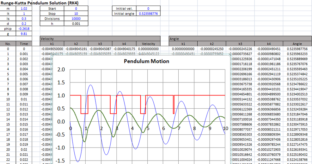

Did some work on this and seemed to confirm the issue that was I was told existed in Excel.
Here is some background to the problem (minus any mention of excel):
https://community.ptc.com/t5/PTC-Mathcad/Pin-and-Pendulum/td-p/332104
In the attached I used an RK4 routine in mathcad (4.0) and then duplicated that in Excel.  (avoiding built-in functions to be apples-to-apples)  Sure enough, in Excel I only see that the pendulum strikes the pin 3 times.  I need to bump the division count up to ~12000 to observe the 4th strike in excel.
So, that's interesting.  I'm curious if anyone seems a flaw in the analysis or has a good explanation for why different results are obtained between two programs.

One observation already:
The Prime implementation uses a definition of f(x,u) which internally does not refer to x.
So it could be better/as well a function of one parameter. f(u).
Changed it, and it does not make a noticable difference..
LucMeekes
(To:DJF)
Found it!
That happens when you implement the functions differently.
The problem essentially lies with the function to calculate the length of the rope to be used.
In Prime the function l(phi) is called from within the function f, using the angle calculated for each k (k1...k4) as it is input to f. In contrast in Excel, the angle used to determine the length is the same for every k.
So once corrected:
Conclusion: (As Werner noted) there's no (major) difference in accuracy between Mathcad and Excel.
(I hope I didn't ruin your case for Mathcad and against Excel.)
