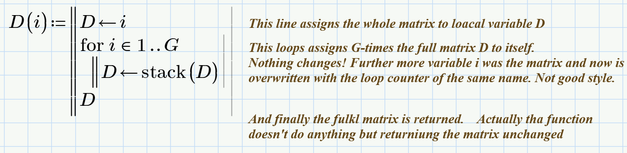

I'm trying to pull G number of rows from an array.  The For loop is not working.  It gives me the whole array instead.

In your attempt you never access a single row of the matrix. Here some comments:
I assume that when G=3 you want the program to return the top three rows of your matrix - independent from the setting of ORIGIN.

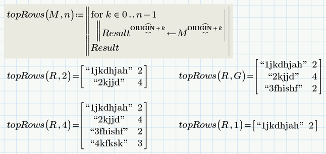

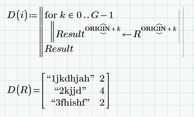

If you insist on using a for-loop you could do it that way using the row operator:

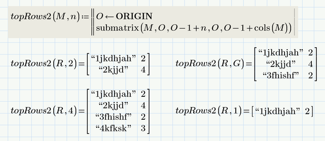

Personally I would prefer using a more generic utility function where the number of rows is an additional function argument:
But what exactly do you have against the "submatrix" function?

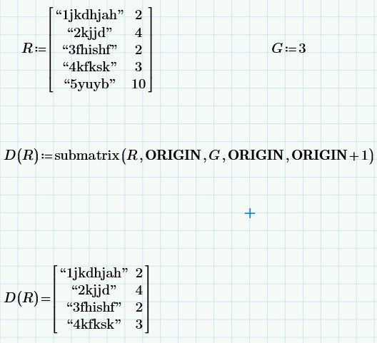

Program attached.
ORIGIN is set to default of 0.  G=3 means fourth row.
Use the submatrix() function.

Yeah,  I did the same.  I thought I should be able to do the same with a for loop.

Thank You. I like the method of calling out the number of rows in the function's argument.
Nothing against the submatrix command.  But your programming is more intuitive for me.
