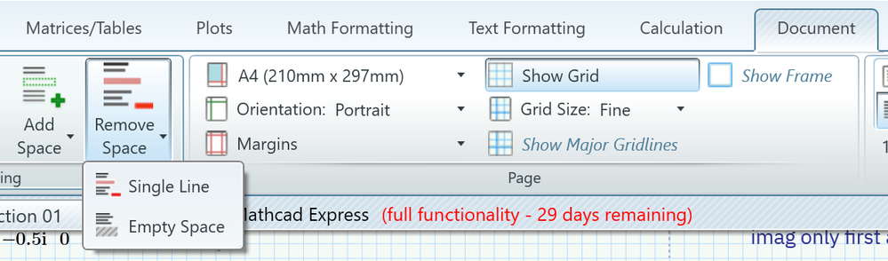

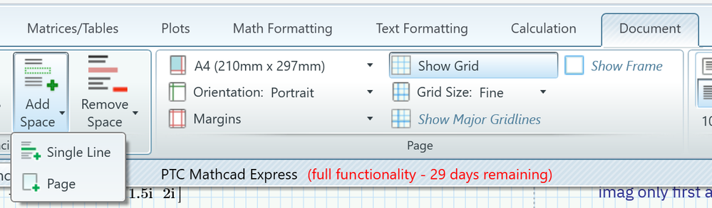

The Mathcad Prime Documentation tab contains two dropdowns for adding and removing space, respectively.   The Add Space button allows the addition of a single line or a page.  The Remove Space button allows the deletion of a single line or all empty space down to the next region (if any).
I frequently add extra pages to allow plenty of leeway for adding new regions in between existing ones.  I always find it a bit of a nuisance having to press the Add/Remove buttons twice to tidy up the worksheet afterwards.
I don't think I've ever used the single line option for either adding or removing spaces.  It is almost trivially easy to carry out these tasks using the Enter or Delete/Backspace keys, switching to Draft Mode if necessary to ensure the correct cursor position (which is almost certainly necessary to use the single-line button options, anyway).
So, I was wondering if anybody makes use of the single line options, or would miss them terribly if the drop-downs were replaced by buttons for just Add Page and Remove Empty Space?

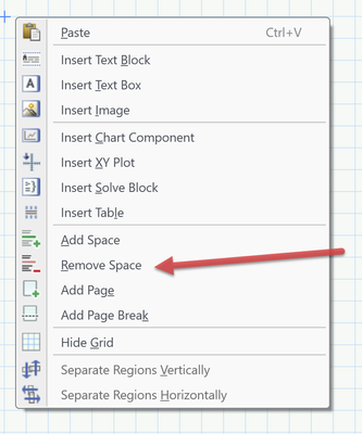

How about using the right click menu?
"Remove Space" seems to default to 'Empty Space'  - there is no option to just remove a single line.
I must admit that I have never used the menu for this purpose—probably because I was unaware that this option even existed in the menu until today. 😉
And because of this - no, I would not miss the single line options.

I was aware of the context menu option, but it just seems more awkward, requiring a bit more mouse movement and then taking care to select the right option ... which can be difficult with my screen resolution, leading to frequent use of Ctrl-Z.  It's the same with other functions, such as cut, copy, and paste.  I either use the keyboard shortcuts or the ribbon buttons.

I think I exclusively use the right-click mouse button menu for removing empty space (which often acts like delete page for me) and add page.
I think I also do that exclusively for add page and add page break.

But I never use them from the Ribbon (too slow), always from the right-click menu.  Usually I can target the line with the mouse and select the option—all in only two clicks and without loosing my focus or switching between ribbon panels.
