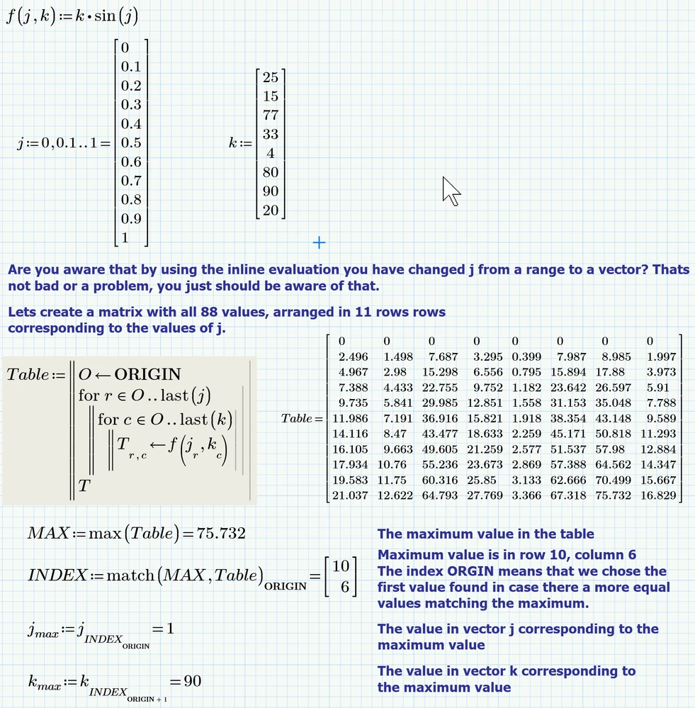

So here is one way to get what you are looking for:
File in Format Prime 5 attached.

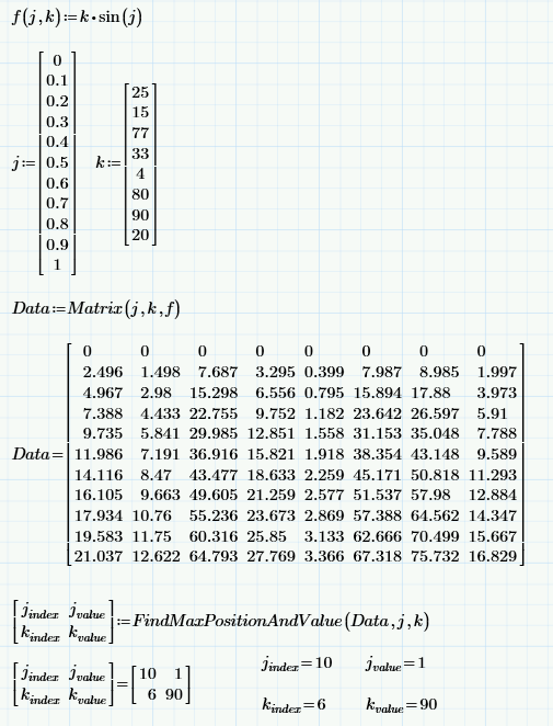

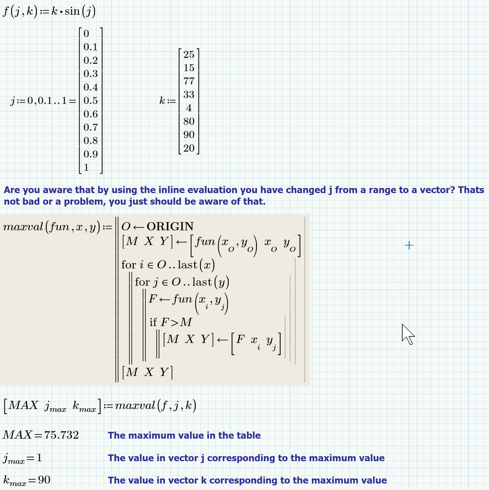

(To:ppal)
Here is a different approach using a used defined utility function
LucMeekes

Here's a compact implementation that also works in Prime Express:
Prime 4 file is attached.
Elegant
