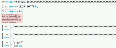

Mathcad Enhancement Proposal:  Change Mathcad's numerical representation of infinity to the IEEE 754 floating-point standard.
When dealing with large numbers, representing infinity as 10^307 can lead to numerical errors and yield ambiguous or unreadable results.
Note: Python math, NumPy, Mathematica and Matlab all give correct results.
I don't know why 2^1020 is allowable, but 2^n, where n:=1020, raises an error.
Stuart
(Numerical ∞ = 10307 has annoyed me since Mathsoft Mathcad days.  At least change ∞ to ⧜ (U+29DC Incomplete Infinity)

Interesting.
Math Result display set to "General".

By the Power of Grayvector and by the Magic of Mathcad’s Unit System, Werner’s work in another thread has inspired a technique for saving us from Thanos by transmogrifying an infinity stone into a very large number of kilograms,
I knew I'd find a use for a finite infinity.  Previously, I could only destroy them two at a time before the structure of the 64-bit floating-point universe threw an overflow error (which wouldn't happen with a proper IEEE 754 infinity).   But now I can handle all of them at once.
I’m not sure it’s a good enough reason to retain 10^307 as infinity, though.

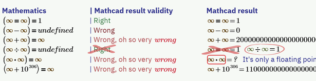

(To:StuartBruff)
Unfortunately only one "Right' out of six:
BTW, you get correct results with the full version and using the symbolics:
in Prime as well as in MC15
StuartBruff
(To:Werner_E)
Thanks, Werner.  Looks like a copy & paste error on my part (I forgot to change the equality operator to division).
Compatibility with symbolic results (where meaningful) is another good reason to implement a proper IEEE 754 infinity rather than an arbitrarily large number, say, 𒌋𒐗 𒎙𒐖 𒑪 𒑪𒐘 𒑪𒐝 𒐝 𒎙𒐝 𒑪𒐜 𒎙𒐚 𒑩𒐗 𒌋𒐛 𒌍𒐕 𒑪𒐕 𒐚 𒑩.
(And if you're going to pick a big FP number, why 10307 rather than 253-1?)
