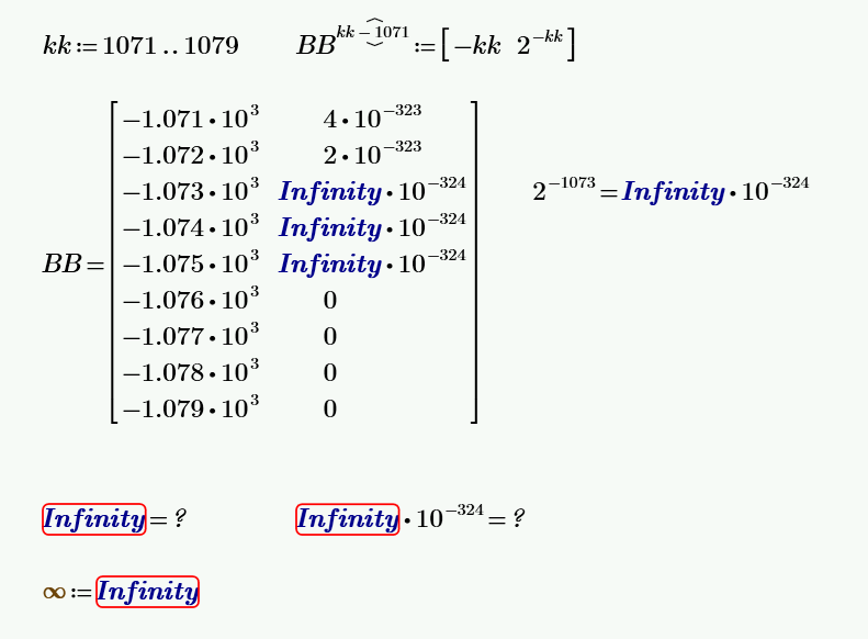

Mathcad Enhancement Proposal:  Change Mathcad's numerical representation of infinity to the IEEE 754 floating-point standard.
When dealing with large numbers, representing infinity as 10^307 can lead to numerical errors and yield ambiguous or unreadable results.
Note: Python math, NumPy, Mathematica and Matlab all give correct results.
I don't know why 2^1020 is allowable, but 2^n, where n:=1020, raises an error.

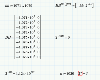

Interesting.
Math Result display set to "General".
Stuart

The 'Infinity' unit was introduced in Prime 6. Up to and including Prime 5 you'd get:
But the funny behaviour with 2^1020 was already present in Prime 2.
