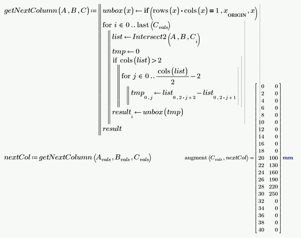

I would like some help to develop a loop in Mathcad that returns x-axis offset distances between intersection points of two curves based on the y-values of the respective curves.
The attached Mathcad Prime 11 file contains the details and a fuller explanation of this request for assistance.
Note, this is a follow-on from an earlier post titled "Mathcad Intersections and Discretized MatrixData". A link to this earlier discussion has been included at the top of the attached file for convenience.
(To:RE_12882698)
I understand the for y=24mm the result should be 160mm and for y=8mm it should be 0mm.
What*s the result for y=20 mm? Should it be 0mm or 10mm? According to the results of
I asseum it should be 100 mm.
What's the result for y=30 mm?  According to
it should be 250 mm.
What, if for different input values A,B there are three or more shaded areas? It would mean that the output should again be a row vector with more than one value.
Here is a solution which follows the above assumptions:

Thank you.
Your assumptions were correct regarding the desired outputs.
Much appreciated.
