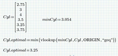

What you are looking for is the match function with the "geq" greater than or equal modifier.
There is no testing to ensure you at least get one match.

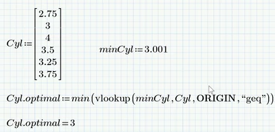

Here is a similar approach using "vlookup" instead of "match".
Its one step less and the vector must not necessarily be sorted (but I guess it would be in your case.
But no matter if you use "match" or "vlookup" - there is a huge drawback in using those functions because they depend on the system variable TOL. The default value of TOL is 10^-3 and using for example 3.001 you get a wrong result:
Obviously the correct result should be 3.25. You would have to set TOL to a lower value (in the worksheet or via the menu) to get the correct result.

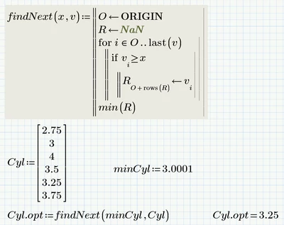

So I would rather suggest not using "match" or "vlookup" and use a small, self written user-defined function to do the job.
Prime 6 worksheet attached
(To:Werner_E)
Here is another, tricky one
OK, it doesn't work if minCyl is smaller than the lowest value in he vector.
But I would turn it into a utility function anyway and while doing so we could also apply some error checking:
