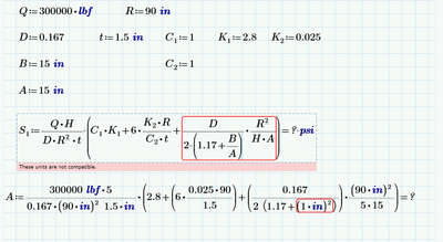

I am trying to solve a equation as provided in handbook but no matter if i use units or not I am not getting the correct result. I tried with applying units but somehow it gives me wrong solution

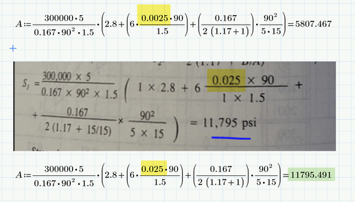

I attach your file here but I guess I found the error - you were too generous with the zeros 😉

This isn't working with units
(To:OM_10154742)
Prime is unit aware and checks for consistency.
You definitely can't add a dimensionless number like 1.17 and an area like 1 in^2.
You sure can only add quantities of the same dimension!
I don't know where this formula stems from and what the meaning of the numbers is, but you get the correct result if you add the unit in^2 to the 1.17.

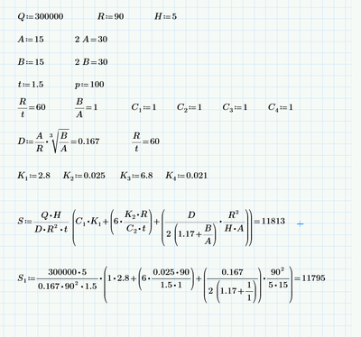

But when i try to use the variable instead of direct number in the same form the result is getting changed
(To:OM_10154742)
Try to attach the worksheet. I guess it should work now.
Maybe the slight difference is because D is not 0.167 but 1/6=0.1666666.... ?
What happens if you write 1/6 instead of 0.167 in the lower expression both times it occurs?
Yes D seems to play the role for increased value in calculation how do i make it stop? I need the solution to be accurate with the variable equation is there any way in prime i can stop the integers to go beyond 0.167 and calculate the value correctly?
(To:OM_10154742)
I seem not to understand.
The result you get when you use the variables IS the correct one.
The other which is using 0.167 instead of the correct value 1/6 is an approximation.
But if you really want to duplicate this result when using the variables, you could define D:=round(A/R*....., 3) to permanently set D to the value rounded to three decimals.
