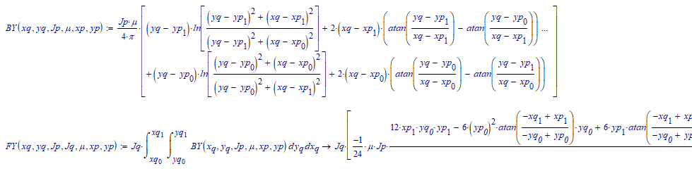

I am needing assistance integrating the attached equations. What I am wanting is a symbolic result of a generalized Maxwell equation for the force generated by the flux density. I have the flux density equations and the Forces (Fx,Fy) is the cross product of the Z cross Y and Z cross X components respectively. taking each independently and integrating twice will result in the the force.
What I need is the resulting symbolic equation.  my attachment only has the Fx info Fy is a similar result. What I am looking for from the community is some suggestions to how to break this down so it will integrate?
Thanks looking forward to your responses.
Richard
April 16, 2019
No need to 'break this down'.
If you want a symbolic solution, start by NOT defining any constants.
Here goes:
Note that the solution is pretty wide, I cut it off just before the end of the first of over 60 pages of landscape width...
