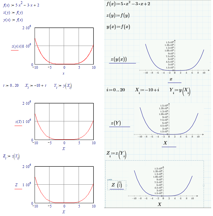

I see no difference in possibilities between Mathcad and Prime in this respect.
Compare for yourself, three possible ways to make the plot you want, Mathcad (11) left and Prime (4) right:
