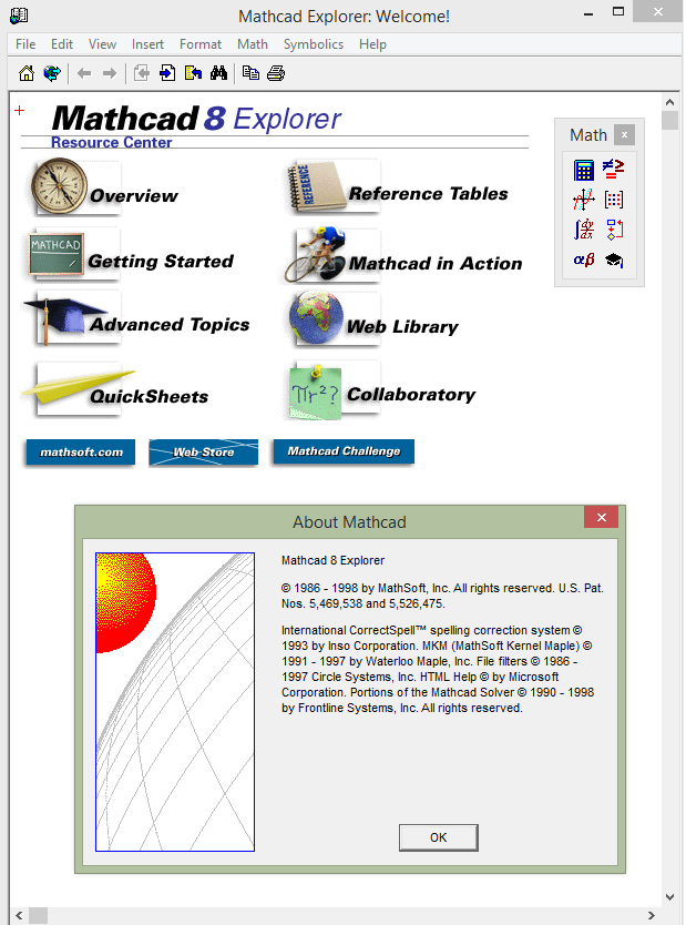

(To:David_K)
 David,
Here is a link to the old version of "Mathcad Explorer 8" - http://www.ecs.soton.ac.uk/~msn/book/mcexp802.exe . You can try to open old files with it:
David_K
(To:VladimirN)
I installed it.  It does not open files created after 2000.  I was able to open earlier files.   The files that I want to look at are all made after 2000.
