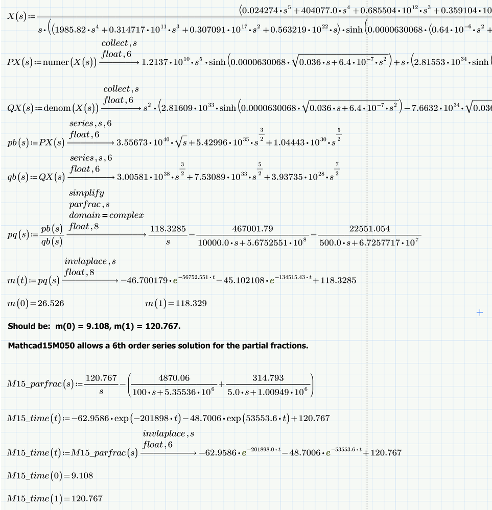

Each package gives quite different "simplifications" to a complex variable quotient. Old Mathcad defaults to a sixth order Series but Prime8 produces a shorter result that is quite different from that of 15M050.
The error seems to be a function of the quotient complexity.
I am careful to run both packages side by side on a new HP Envy laptop as I try to transition to Prime8 while writing a patent disclosure.
This error makes Prime8 unusable for what I do.
Has anyone else seen this?

Its absolutely unclear to me which "difference" you are referring to as you don't show any examples.
Best guess is that you are talking about symbolic evaluation.
Prime starting from version 6 uses a different symbolic engine (a free one as opposed to the older muPad which PZC had to licence from Mathworks). I understand that the new engine is less powerful but is a work in progress as PTC tries to develop it, fix errors and maybe even add new tricks.
Control over the output of a symbolic evaluation never was easy in Mathcad and the possibilities are quite limited.
If you post examples of your expression and make clear, which kind of result you need, someone may be able to achieve better results as with a simple "simplify".

I am simply solving:  H(s) = P(s) / Q(s) followed by rationalization, partial fractions and InvLaplace.
Old Mathcad defaults to a sensible 6th order solution for numerator and denominator which you can reduce if
the partial fractions generate right half plane poles and you know that this cannot be.
Prime8 generates RHP poles if I use a Series greater than 3 and the numbers are wrong. Ohms law sets these limits.
I have played with Labelling and kept things very simple as I try to produce a patent submission in Prime8 dealing with arc fault suppression.

Still unclear. Why don't you post some examples? Screenshots and preferably the Prime sheet as attachment.
Hi Werner. It is part of a Patent pending disclosure.
(To:JohnArcher)
I didn't meant that you should post your original work which as I understand you can't do.
You could use similar demo expressions not connected with the Patent but still showing the problem to demonstrate in which way you think the results of the new symbolic engine are "wrong" , as you wrote. Chances are that the results aren't wrong but still are correct, but just simplified in a way you did not expect like seen in the example @rgunwaldsen  had posted, where the new symbolic simplifies the fraction by cancelling the factor (s+4) before returning numerator and denominator wheras the old engine would return the expression in the definition.
BTW, for simple numerical fractions this same behaviour is also seen by the legacy engine - numer(8/6) would return 4 with both engines and there seems not to be a way to avoid this automatic internal simplification of 8/6 to 4/3. One can argue if "4" is "wrong" or just "unexpected" or "less/not useful".
But from what you revealed so far, you are not having problems with "numer" and "denom" but rather are using "parfrac" and "invlaplace" on a rational transfer function. Not sure which problems you are facing there. It may be that the new engine is erroneous (there were already reported quite some bug in that engine here in the forum), but it might also be the the engine is doing OK but not the way you expect it. If the latter is the case there is a (very small) chance that using the right modifiers and keywords in the right order might give you what you are looking for.

I was able to open the file he posted in Prime 6 and I see after recalculation the results you show,
Prime 6 is the last version which also includes the legacy symbolic engine (muPad) which is also working in Mathcad 15. The results usually are the same as in Mathcad 15.
I wasn't willing to retype your expressions in Mathcad 15, so I stayed with Prime 6 and switched to the older symbolic engine, changed "series,3" to "series,6" as you suggested and here is what I see after recalculation (the results if m(0) and m(1) seem to remain the same as with the new engine).
So for whatever it may be worth here is a screenshot of your sheet recalculated using the old symbolic engine:

I do hope that a solution is found. I have diligently looked at my 15M050 worksheet and found no errors component calculations in that or my Prime8 version.
I cannot reproduce the Prime8 Simplification in 15M050. Its composition has the correct powers of the complex variable, but the number are wrong.
