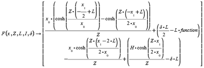

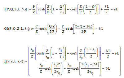

This is your Mathcad 14 file:
And this is what you have in Prime 8:
Note that in the second function of F you have an H that should be an x[0
That is one thing you need to fix.
Then, symbolic evaluation of F itself gives:
Which demonstrates that Prime 8 has a bug where it fails to see I as a parameter to the function F, it is confusing it with the function I() that you defined above.
Finally you're running into autolabelling problems. Make sure all your variables are labelled as a variable, and your functions are labelled as a function, then see what happens.
I got this:
I'm afraid this does not make you happy.
(To:JM_10241707)
It looks like the symbolic evaluation of the "Jacob" function got broken in Prime and needs to be fixed.
