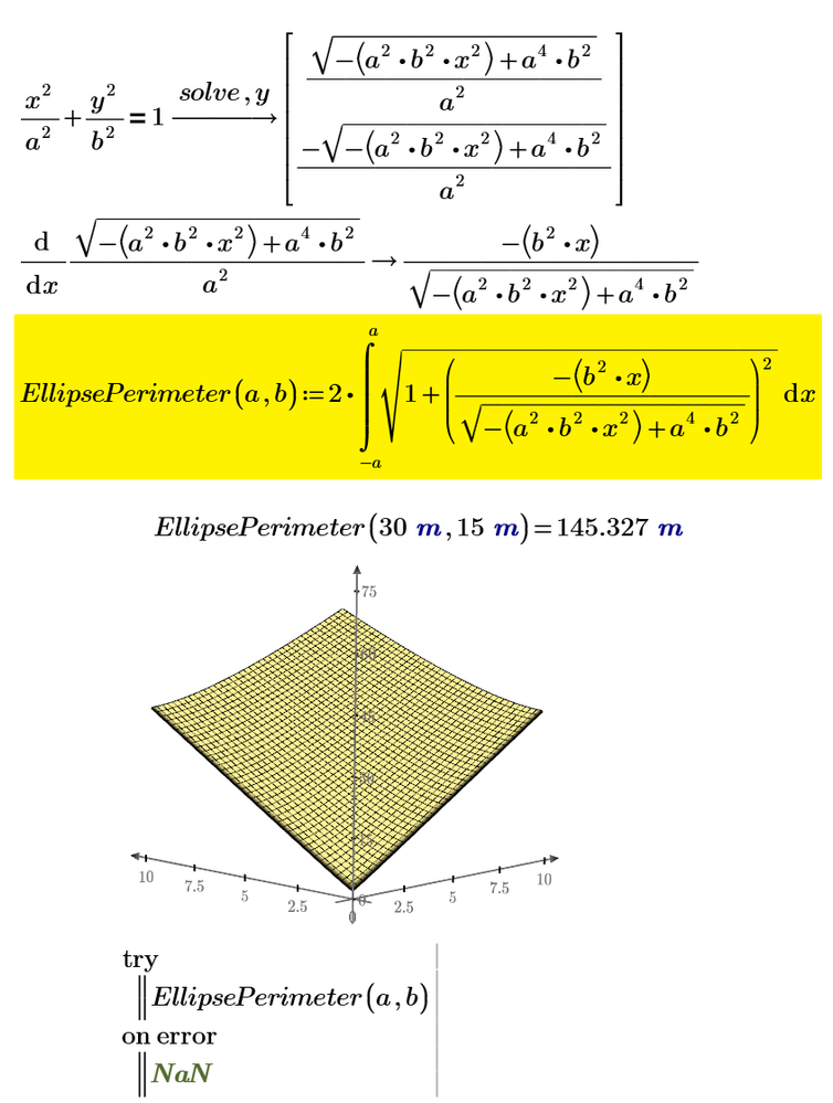

I am shocked that I have walked the surface of this planet for over 5 decades without realizing that there is no exact closed-form solution for the perimeter of an ellipse. In school, we learn the perimeter of shapes like triangles, squares, rectangles, circles, parallelograms, and so on, but I feel like schools and teachers conveniently skipped over ellipses.
(An ellipse, in case it’s been a while, is the set of points where the sum of the distances from two points – the foci – is a constant.)
Your challenge, should you choose to accept it, is to correct that oversight. Create a Mathcad worksheet that:
  • Derives, depicts, or shows one (or more) of the various approximation formulas / methods for the perimeter of an ellipse.
  • Create a calculator whereby someone can change the values of the semi-major and semi-minor axis lengths in order to find the perimeter.
  • Create a 3D plot of the perimeter as a function of the ellipse semi-major and semi-minor axis lengths.
Although there is no exact solution for the perimeter of an ellipse, this is a fairly well-documented problem. Therefore, your documentation in your worksheet is key! This worksheet should be able to stand on its own and be understood by someone with a basic knowledge of calculus (since integrals and infinite series are involved).
Good luck and have fun!
Find the Mathcad Community Challenge Guidelines here!

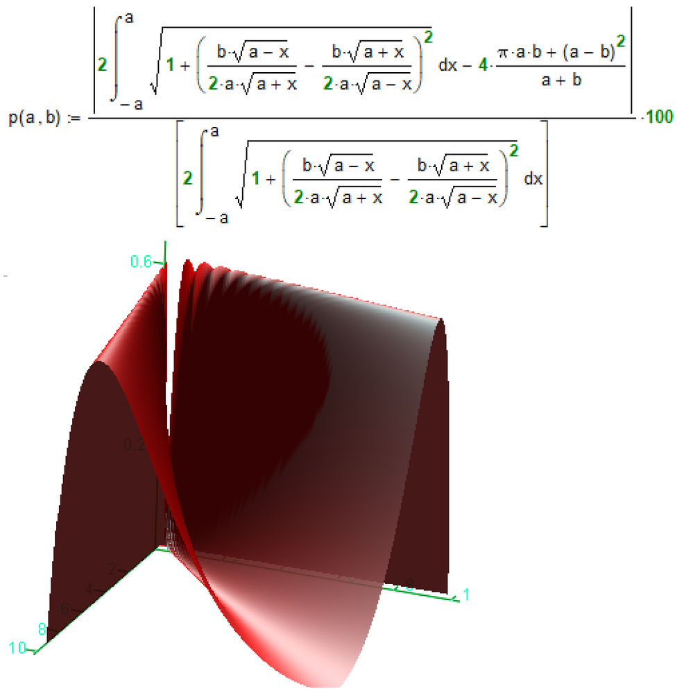

I once won such an argument a long time ago - I showed two ellipses (Mean) for which there is an exact formula for the perimeter. One of them is a circle, and the second - see the picture.
A more challenging and interesting problem is the Cassini Oval (gmean) and the Cayley Oval (hmean)!

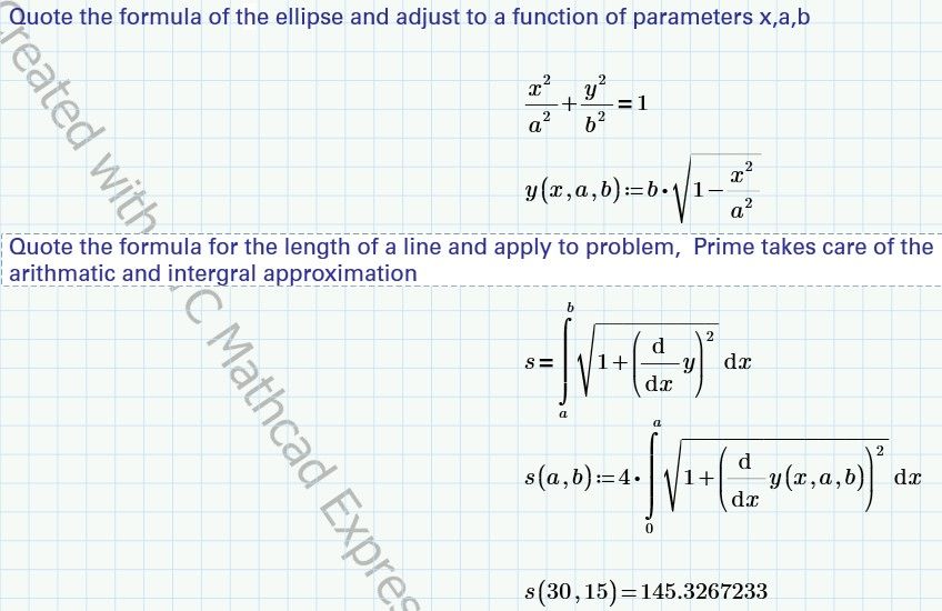

My attempt attached (excludes part 3 as 3D -plotting not available in Express).

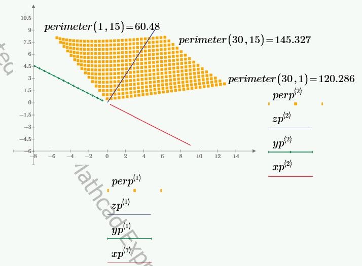

Am enjoying the posts so far so want to add a quick from 1st principles approach:
Just could not resist it.  A page of matrices and voila 3D plot in express.
Capture.JPG.

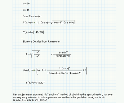

A friendly hello to the puzzle group,
I only have MC14 available. Therefore I couldn't read all the posts. Therefore, here is just a reference to a very good approximation function for the circumference of the ellipse - it is Ramanujan's formula. I don't know of a better one from the literature. I have attached them, but I cannot provide the desired 3D plot. I'm asking for help here.

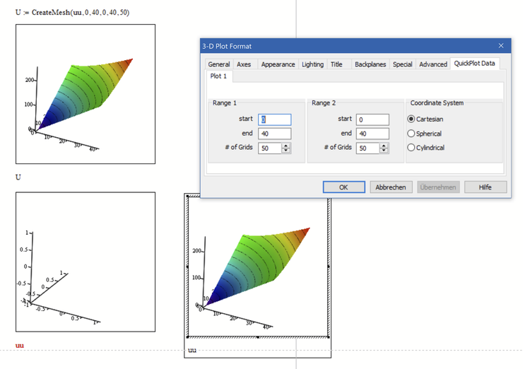

Your function uu() has two parameters so producing a 3D plot is simple with the matrix() function.
Cheers
Terry
I would strongly vote against using the matrix function to do the job! It may give a decent result here but you can't use it to provide intermediate values (non-integer arguments) or negative arguments.
The way to go sure is using the CreateMesh() function which is exactly made for this.
We could also plot the function uu directly but in this case it will fail because the function uu is written in a way so that it yields non-real values for negative input arguments. And because the standard interval for a 3D Quickplot is from -5 to 5, this makes the whole plot fail.
But if we force the argument values to be in the desired range, plotting uu directly works as well.
Nonetheless I sure would vote for using CreateMesh when creating 3D plots of functions in 2 variables.

Using Ramanujan Approximation.
From MARK B. VILLARINO
192_05.pdf (emis.de)
