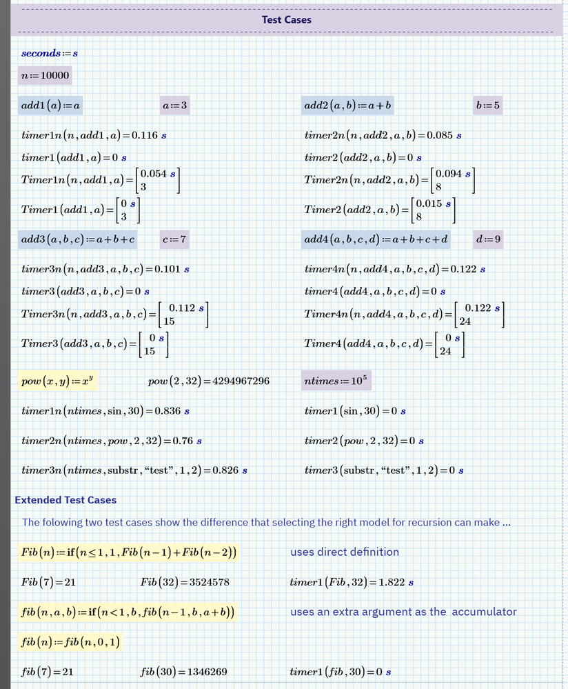

I've been doing a bit of revamping my Mathcad Express worksheets to Mathcad Express 11.  As part of this activity, I've updated my library of timing functions to reflect the way I've been using them.
For example, timer1(f,a) used to return both f(a) and the time it took to evaluate f(a); now, it just returns the time taken, whilst timer1n(n,f,a) executes f(a) n times.
For those of you with prior versions of Mathcad, here are the timing function definitions:

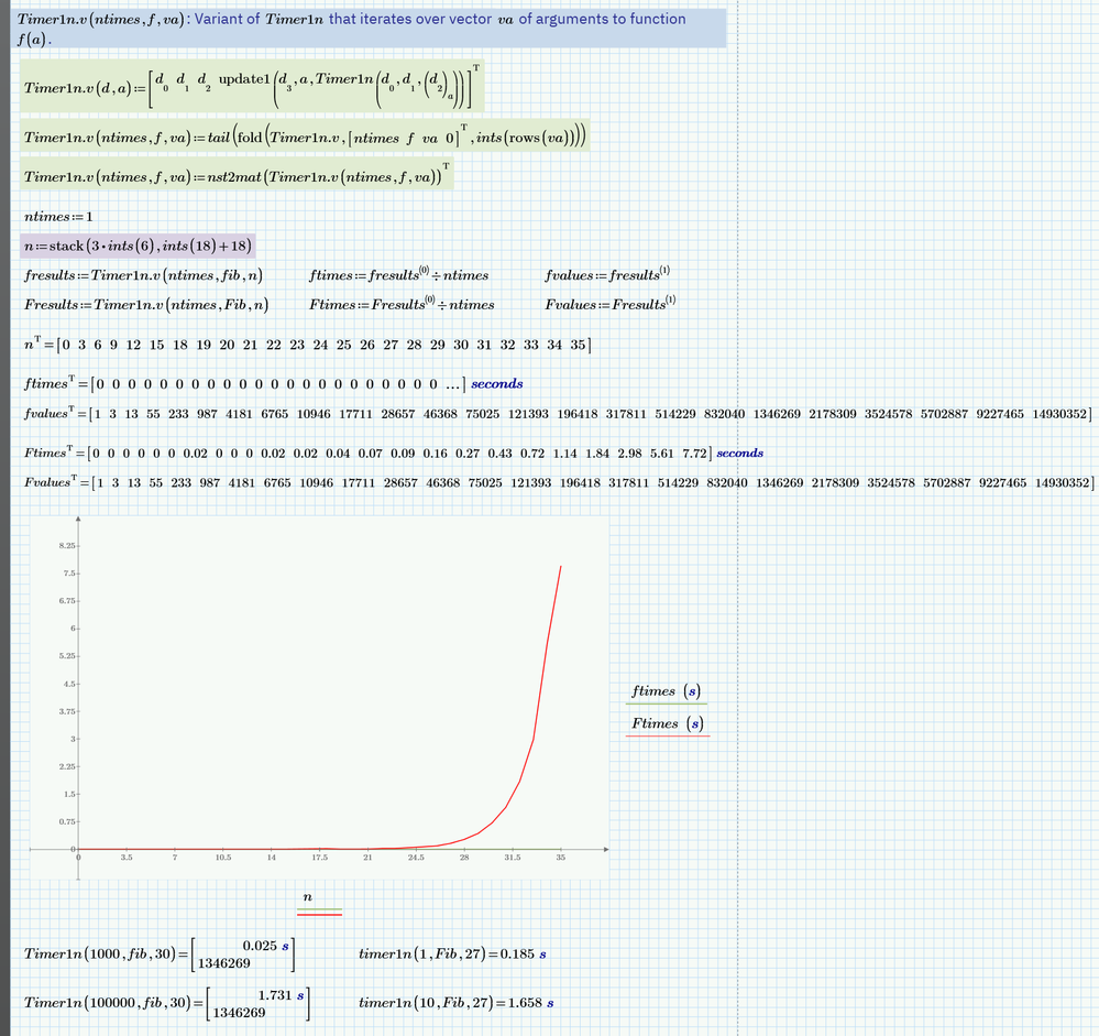

Here is a good example of how writing recursive algorithms should be done with care, fib vs Fib.
And here's a graph showing just how much worse the difference in Fib's performance gets as its input argument n increases.
