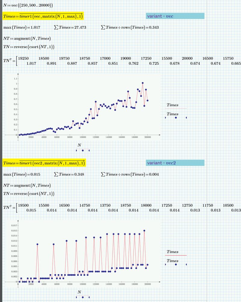

While updating an array reshape function, I noticed that the performance was deteriorating as the array size increased.  This in itself wasn't too surprising, but it was a lot slower than I'd have expected from an O(log(n)) algorithm.  A mere 50,000 elements were taking 3 to 4 seconds to vectorize (confusing terminology in Mathcad terms, I know, but it is common in mathematics - see links at the bottom of this post)
reshape, however, used a vec variant to flatten the target array into a vector, before creating a suitably dimensioned array from the resulting vector, and vec proved to be the reason for the performance problem.

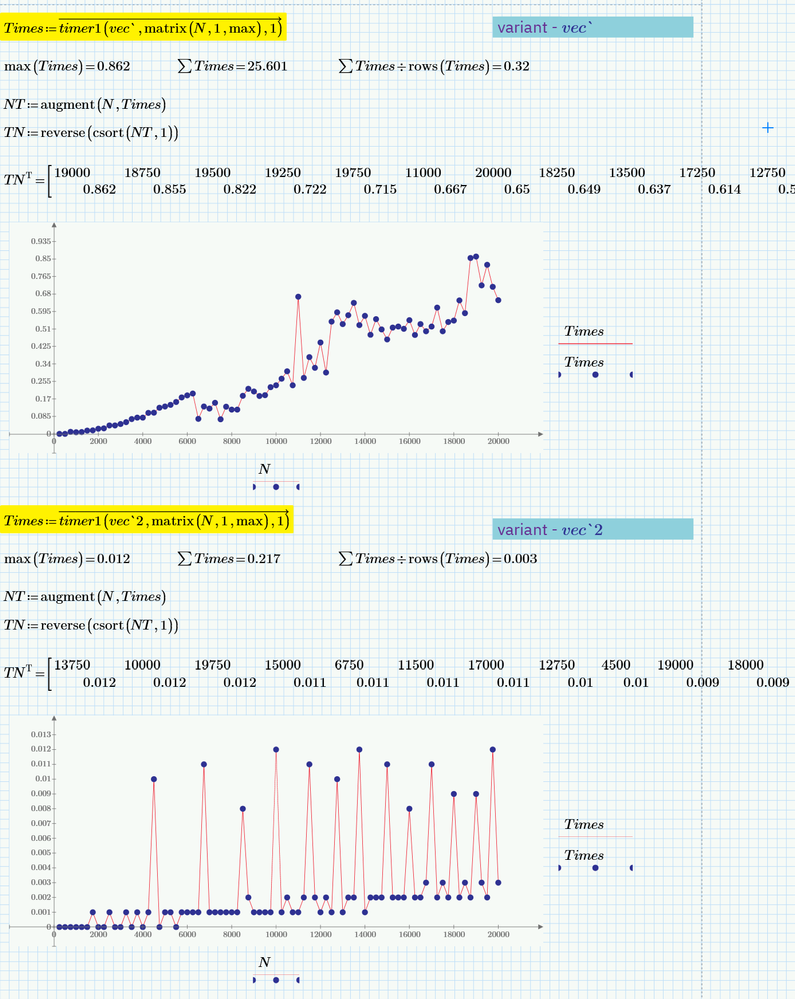

vec uses fold to apply a bespoke stacking function to its input argument.  I wondered if there was a means of speeding it up and tried another undocumented function, update1, to directly insert elements rather than stacking them.  This produced a remarkable increase in speed.

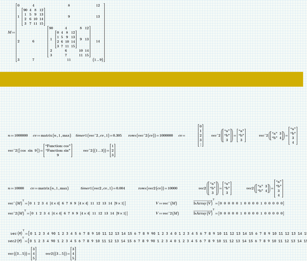

Note that in the definitions below vec` functions only flatten the first level of a nested array, whilst vec variants completely flatten an array, including expanding any nested range variables.
vec` and vec definitions:
vec` and vec examples:
vec performance comparisons:

vec` performance comparisons:

I was wondering if there is something intrinsically wrong with my standard fold approach or if I've made a mistake in implementing it?
Are there any other techniques Express could use to speed up (recursive) algorithms?
