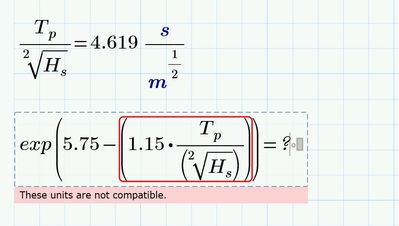

Mathcad Prime 4.0 ( Need the the solution for this problem ASAP )
I need the solution for the problem shown in the attached photo asap.sasa.jpg
Thanks in advance.
Thanks in advance.
As your error states, you have a unit unbalance.  If you make the second term unitless the problem will solve:
Note that the units chosen may affect the result.
Thanks in advance.
Thank you so much, it worked and the result is accurate.
That will not work lake that.
You are subtracting a number with units (the expression involving the square root) from a number without units. That makes no sense.
Figure out the meaning of 1.15 and 5.75, or if you need to supply Hs and Tp without units.
Luc.
Thank you so much. You are right!
