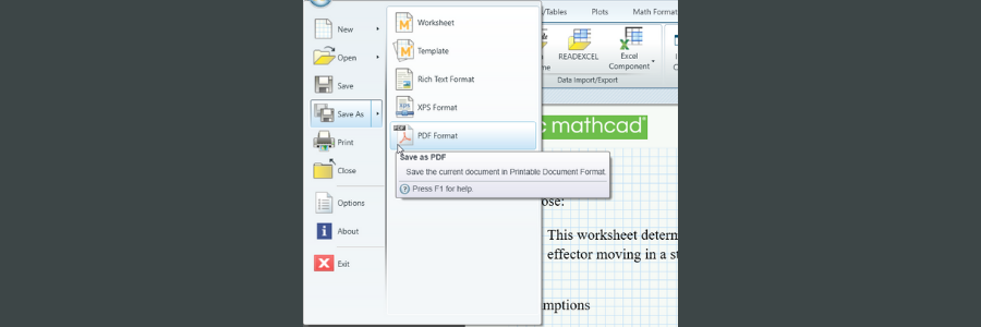

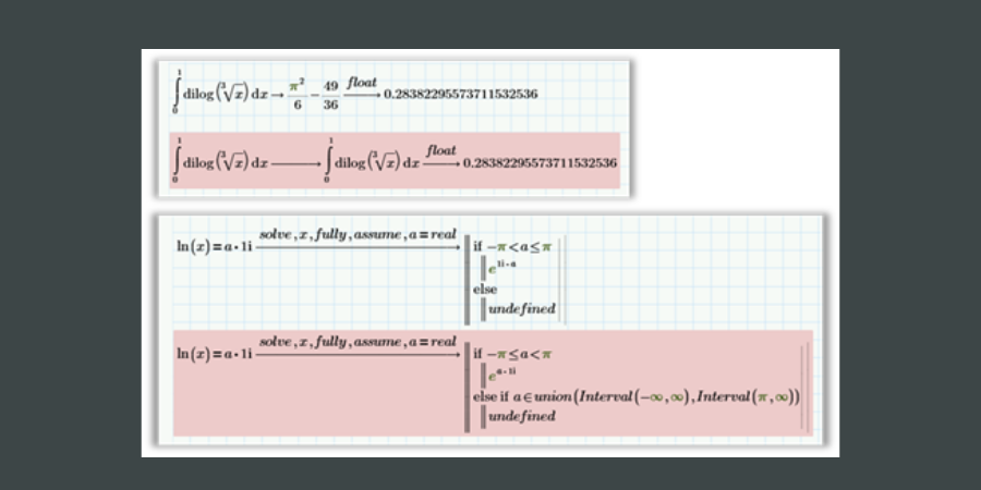

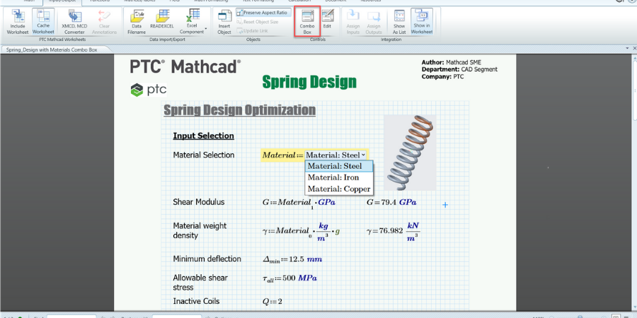

Combo-box input:
Symbolics:
PDF:

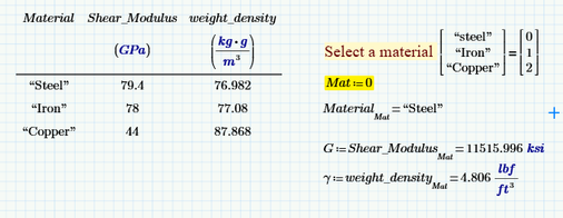

And the combo box (like the third party graphing app) doesn't support units!  If I use a table, and a text box to prompt a choice, even Express can do better:
If I were going to use on of these controls, I'd want to be able to put my choices
inside a closed, LOCKED area so the units don't get messed up.  (Can you say, "NASA Mars flyby?")

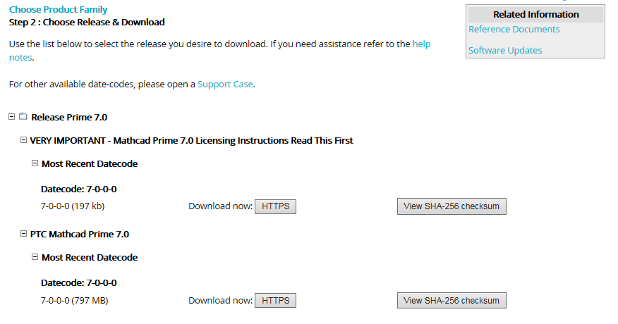

I just found that Prime 7 is available for download...let's see what it's got in it...
Fingers crossed!
Came here to confirm that it's officially out.

Seems to be accessible only for maintenance customers at the moment...
