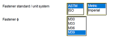

I have encountered a problem. Normally, I know how to prepare a list box, but in this instance, I need to create a dynamic list box such that input from another list box influences it.
Specifically, I need to create a list box asking for the “Bolt Type,” but for that, I need two inputs, similar to a real case scenario: Bolt types depend on “Standard” and “Unit System.” Please find the attached image that I saw in a PDF.
Please help me to create this in Mathcad Prime. Thanks in advance.
The image:

BTW, it looks like the picture you show does not stem from a Prime sheet but rather from a real Mathcad worksheet.
If you have access to the worksheet itself and not only to a pdf print, you may try to let Prime convert it to the new format. At least it may be wort a try though I have my doubts if the converter wold be capable enough.
