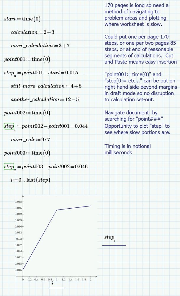

Well done to get the size down.  By sections I mean insert the "point###:=time(0)" and "step[0:= etc.." by page 170 steps, or two pages at a time 85 steps,  or reasonable calculation steps.  Keep the file as one item.
This way a plot of timing in each step can show where to concentrate some effort in speeding up worksheet..

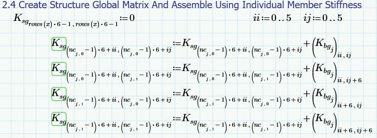

Matrices - define the last element first as this avoids Prime resizing it.
Avoid for loops and use indices instead of programming.
For example large matrix first and indexing using range variables instead of for loops in programming.
The Prime below is complex and fast.
Memory management is smaller if you use programming for intermediate matrix and variable calculations as the local variables inside the function are deleted after program is run.

170 pages can be broken into sections and put timing marks to determine where the slow bits are and concentrate on speeding up them.

By "sections", do you mean areas/regions or to break up the calculation into separate sheets and reference them? As I understand it there's no sub-routine functionality in Prime and also no Ebook functionality, like MC 15, for creating tables of contents.
Thank you so much again for the help!
John.
