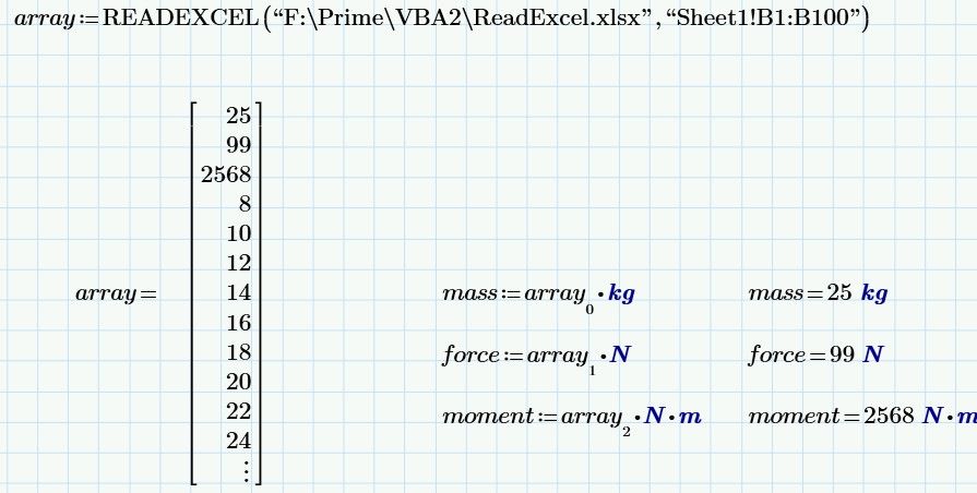

I am stuck in matrix. I need to assign these values as real number instead of matrix
For example
In excel we have:
A1 cell has 25
A2 cell has 99
A3 cell has 2568
So in Mathcad
a1=25
a2=99
a3=2568
and then few calcuation is performed
Note: I have different units for these values for example kg, N, Nm etc
Unfortunately I am new with mathcad and no idea how can convert matrix value to the real numbers.
The example you have provided it running flawlessly. I really appreciate that you find time and helped me 🙂
Thanking you in advance
Beware that the default origin for arrays (vectors and matrices) in Mathcad is 0, not 1, so your first array element may be a0 in Mathcad.But you can set the ORIGIN to 1, if you want to refer to the first array elemenet with index 1.
You say you need 'real' numbers, I guess you mean that you need scalars (as opposed to arrays), to work with you calculations in Mathcad. Well, if your array in Mathcad is called a, and it has three elements, the first element (by default) is a0, and you get it by typing (in mathcad): a[0
and this a[0 is a scalar. If you want to refer to it otherwise you can assign it to a variable with an appropriate name, e.g.:
Mass:a[0
(This will show as:  LucMeekes_0-1647877885716.png  )
Excel doesn't know about/work with units. Hence there is no way to export united values from Mathcad to Excel, or import values with units. There are (at least) two methods to work around this:
1. You work with implied units: e.g. a1 is (always assumed to be) in kg, a2 in N and a3 in N*m. Then when you assign a1 to the variable Mass, you apply the correct unit. E.g.:
Mass:a[1*kg, which shows as LucMeekes_2-1647878425656.png.
2. You add in Excell a second column (B) next to the column with values. And you put in that column the units for each of the values as string values ("kg", "N" and "N*m"). In Mathcad you now must fetch the two columns from excel simultaneously, that will result in a 2 column matrix in mathcad. Now you can examine the unit strings for each of the values and apply the respective units. Note that there is no built in feature in Mathcad to do so, so you have to write your own mathcad program to apply these units, making sure that you account for every possible unit string that you want to use in Excel.
I suggest you start with option 1.

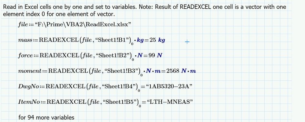

Is there any way in mathcad to convert the matrix or vector into scalar? I do not need data back to excel. If it can tranfer simple values from excel to mathcad and assign to individual variable that work perfect for me (unit is not a problme for me). The example file you have given, it is assigning the entire hundre value from excel to one vector in mathcad instead I want these hundree values are assigned to hundred of variable without the square bracket [,] in mathcad.
In some of excel cell I have drwaing and item no as 1AB5320-23A and LTH-MNEAS
I want this also to be sent from excel to mathcad and that can be assigned in mathcad  as Drwaing number=1AB5320-23A  and item no=LTH-MNEAS

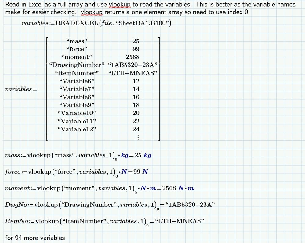

There is two ways to handle this.  I prefer the second as it keeps track of variable names.
These option with direct insertion of excel read command has one flaw. When some value from excel get updated it does not update accordingly. I am trying to make it simple. I have Creo where my data is available, 1st step to fetch data from Creo and save in excel sheets then these data are tranfered to mathcad in simplified way rather than typing those in mathcad. like vlookup in mathcad an so on... I have several variation of product and want to simplify it to reduce my workload
Simplest is to use array indexing.
