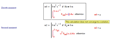

Now, i have another sheet with contain error "the calculation does not converge to a solution"
could you please have a look and appreciate your input. I have attached mathcad sheet for your reference.

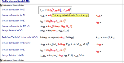

I am trying to finalizing this Mathcad sheet with continuation of formulae. I have been setup the other matrix. Then, i got error notification like below.
I not sure what happening with this. When i tried to track error, this link to below snapshot.
I have attached my full set draft of mathcad sheet hopefully you can have a look and further advise.

There is a lot of red. This might take a while.

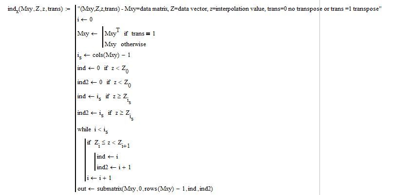

Can you explain in words what you expect this programming routine does then I could be more help.

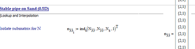

Hi Terry,
Thanks for your response.

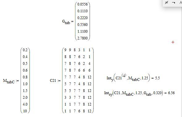

The programming in based on my understanding is for allow me to lookup and interpolating of function / value of each parameter from the table section (as shown in below picture). So, as an example i can define l.10 value based on the interpolating value from the table below.
Hope short words will help to solve this.
Cheers.
Aries

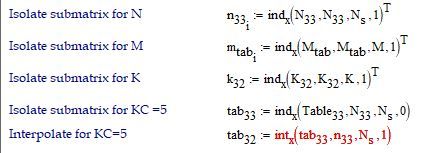

I think i have "ind.x" programming working.
Working on "int.x" programming.

Thanks for the extracts I can see what you are intending with the programs.
It is 4:00 am my time I need a little sleep having been up all night.
I am confident I can solve your problem when I wake up.
Cheers
Terry
Hi Terry,
My apologize for that. I just realize we have different time zone.

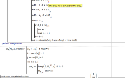

Have reworked the interpolation functions
Inty is an interpolate of one column of Data by a column vector Mcol at a data point y. y is clipped by the program to the range of Mcol.
Intxy is an interpolate of one matrix of Data by a column vector Mcol for the column key and by a column vector Mrow for the row key. y is the interpolate point down the column direction. x is the interpolate point across the row direction
These new functions need to be applied to the end of the worksheet.
Appreciate your help. I've tried with your change apply to the interpolation but i couldn't find real value.
Also, when i want to see value of n.33 it's seem like unreal number.
If you can have one example of your method apply in this mathcad sheet with output value of l.stable up to W.stable that would be helpful.
Done and enclosed in latest version of sheet. Have not gone further with solution on clay as Su is zero in your input table.
