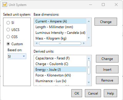

So I have just installed MathCAD Prime 11 so that I can finally have custom units. So now I can get 'MPa' and mm as my preferred units, but how do I get MathCAD Prime 11 to evaluate a moment as 'kNm' instead of  'J' (joules)?

Change the preferred unit for Energy from J to kNm....

I don't see how you do that?

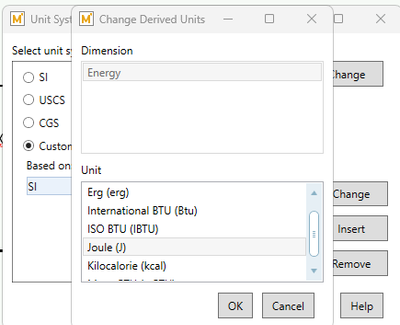

this is what I am faced with, there is no option to change the unit associated with energy as far as I can tell. When you click on change there is no option to change it to kNm?
LucMeekes
(To:sjupp)
The unit kNm isn't known by Mathcad, you'd have to define it first as (e.g.) :
be sure to have kNm, N and km labelled as Units.
What happens if you change the unit for energy to BTU...do then your moments change to BTU?
(If not it's no use trying to get kNm in there).
