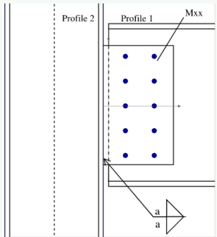

for now i have given op on importing images as a figure and have made a compromise where i use an image as the background and have a plot in front to show the correct number of bolts as shown below
It is not a perfect solution but accetable for now.
