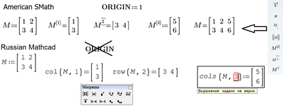

Our Mathcad Community forum has an Ideas section. They don't let me in there for political reasons. Thank God they're still allowed in here.
The best idea for Mathad is to take all the good things from SMath.
I will post pictures here describing some of the benefits of SMath over Mathad.
I ask those who have access to the Ideas section to transfer my drawings there.

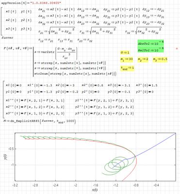

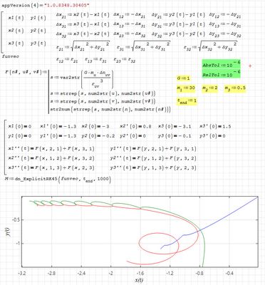

@ValeryOchkov wrote:
Is satellite interception weak? With animation!
Translated by Andra Chirila using Google Translate on April 4th, 2023
-----------------------------------------------------------------------------------------------А перехват спутника слабо сделать? С анимацией!
Thanks, but without animation and I can!
Спасибо, но без анимации и я могу!

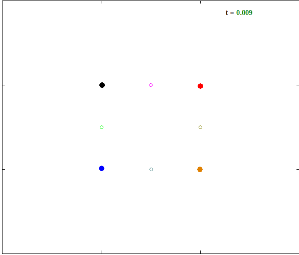

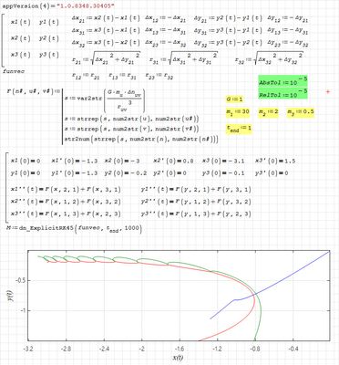

Because I do it, no. This is not all that ODE solvers can do.
Так как я это делаю - нет. Это ещё не всё, что могут делать решатели ОДУ.
Анимация есть тут.

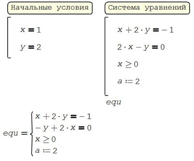

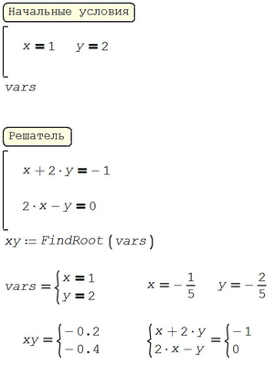

Is it possible to push Minimize & Maximize into this block?
А можно Minimize & Maximize в этот блок запихнуть?

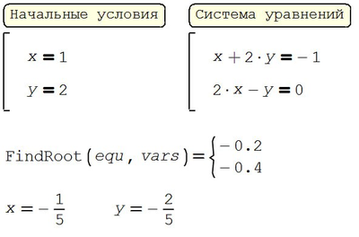

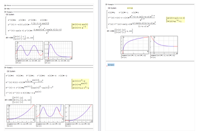

This block is not tied to solvers, it either collects expressions within itself and returns a system of them, or, if a function is specified, inserts the first parameter (system) into its expression and calls the resulting expression. The block itself does not perform any transformations with expressions. Its purpose is to pass its content as is to a variable or function. All examples with the block can be done without it, it just allows you to more freely set up the problem.
Knowing this, you can use the block as you wish without any restrictions. It is compatible with any solvers that take a system as the first parameter. Those. all numerical ODE solvers (~30-40 pieces) work with it. FindRoot() and solve() work in a similar way.
Examples are on the official forum, where the Mathcad Toolbox add-on is described.
Этот блок не привязан к решателям, он либо собирает выражения внутри себя и возвращает систему из них, либо, если указана функция, вставляет в её выражение первый параметр (систему) и вызывает получившееся выражение. Сам блок не выполняет никаких преобразований с выражениями. Его назначение - передать своё содержимое как есть переменной или функции. Все примеры с блоком можно выполнить и без него, он просто позволяет более свободно делать постановку задачи.
Зная это, можно использовать блок уже по своему усмотрению без каких либо ограничений. Он совместим с любыми решателями, которые в качестве первого параметра принимают систему. Т.е. с ним работают все численные решатели ОДУ (~30-40 шт). FindRoot() и solve() работают аналогичным способом.
Примеры находятся на официальном форуме, где описано дополнение Mathcad Toolbox.

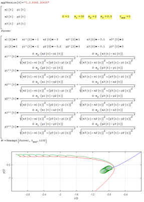

This is the third variant of solving the problem with interception. I tried to make it shorter, but the result began to differ, so I will not give it for now. This form of writing the problem allows you to do not a block, but the solver itself. More precisely, all such ODE solvers support it.
Это третий вариант решения задачи с перехватом. Я пробовал сделать короче, но результат стал отличаться, поэтому пока приводить его не буду. Такую форму записи задачи позволяет делать не блок, а сам решатель. Точнее говоря, все подобные решатели ОДУ её поддерживают.

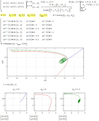

Three alternative solutions for different accuracy.
The shortest option.
Самый короткий вариант.

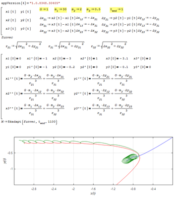

SMath Studio differs from Mathcad in that it has a modular structure. It is necessary to track not only the version of the program itself, but also the versions of the add-ons used.
The other day I made a small correction in the ODE solver algorithm so that the shortest version can have the specified form. Previously, the document would not have worked in this form (it would have been a little larger).
At present, numerical ODE solvers cannot be used directly to solve systems in which higher derivatives cannot be derived explicitly. Here I gave an example of how this can be temporarily bypassed (Mathcad Block. RKA (Razonar).sm). The general algorithm has not yet been implemented.
All ODE solvers return not only the decision matrix, but also the desired functions, approximated using lspline.
