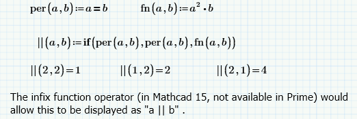

(To:JB_9681141)
I have found no reliable way to do that in Mathcad.
Do you really need it to short-circuit?
If your first expression is 'per',  then the second expression 'per<0' can also be calculated...
Mathcad (or at least as I use it) doesn't have functions that return logical true/false.  How about
playing games:
