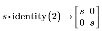

s is a variable.
The result should be:
It seems that Mathcad Prime 7 does not want to show the result, to calculate...Mathcad Prime thinks, thinks, and thinks again.

Prime 8 can do. Check identity has label as function.

When I open your sheet in Prime 6, this is what I see

And even in my Prime 7, after some 5 seconds, 'identity' turns from automatic to function label and the symbolic solution is presented:
